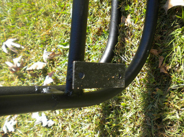

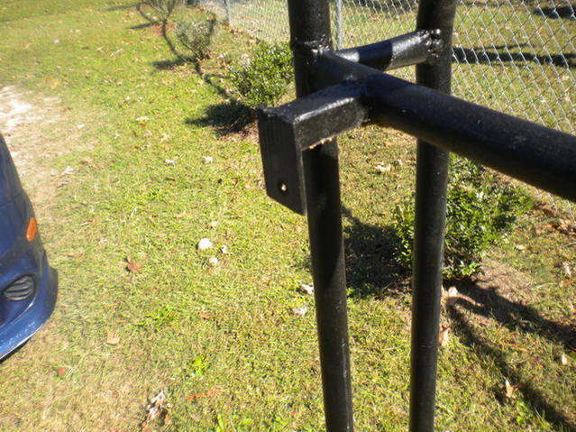

Matthinnant, found pics of the one blee made you but only on the ground. Any of what it looks like mounted? What mounting style does it use? Custom feet?
Yea I will take some pics of it tomorrow I gotta repaint it a lil where it got scuffed up from shipping but I will make sure to take pics of the tabs for mounting.
THE 1st pic is the rear tabs and the 2nd pic is the front tabs hope this helps

that is basically how we made our first racks feet, but the problem with that is that our racks are both curved/arched front-back and side-side so you have to get the angles just right or it doesnt fit properly and yeah you will bend crush your rails or tweak the roof. ours are set up with shoulder bolts and are on an axis so that they can have some "play" and will fit the natural curve of the roof
Well Blee1 made it off the replica of his for his 4runner but hopefully it wont tweak anything but if it does then I will def take your mod into consideration, I have to grind down the tabs a little because they are to wide for my rails.
