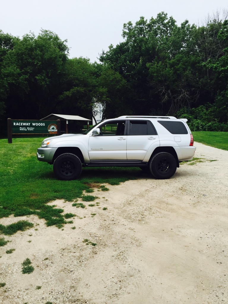

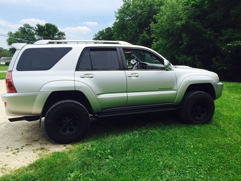

Here is mine with TRD Tacoma front springs and 1/2" Toytec spacers, rear FJ springs with Daystar 1.5" spacers, and 2013 Tacoma Bilsteins all the way around. Overall, I ended up with about a 2.5"/1.5" lift. It rides really well with this combo.

Here is mine with TRD Tacoma front springs and 1/2" Toytec spacer, rear FJ springs with Daystar 1.5" spacers, and 2013 Tacoma Bilsteins all the way around. Overall, I ended up with about a 2.5"/1.5" lift. It rides really well with this combo.

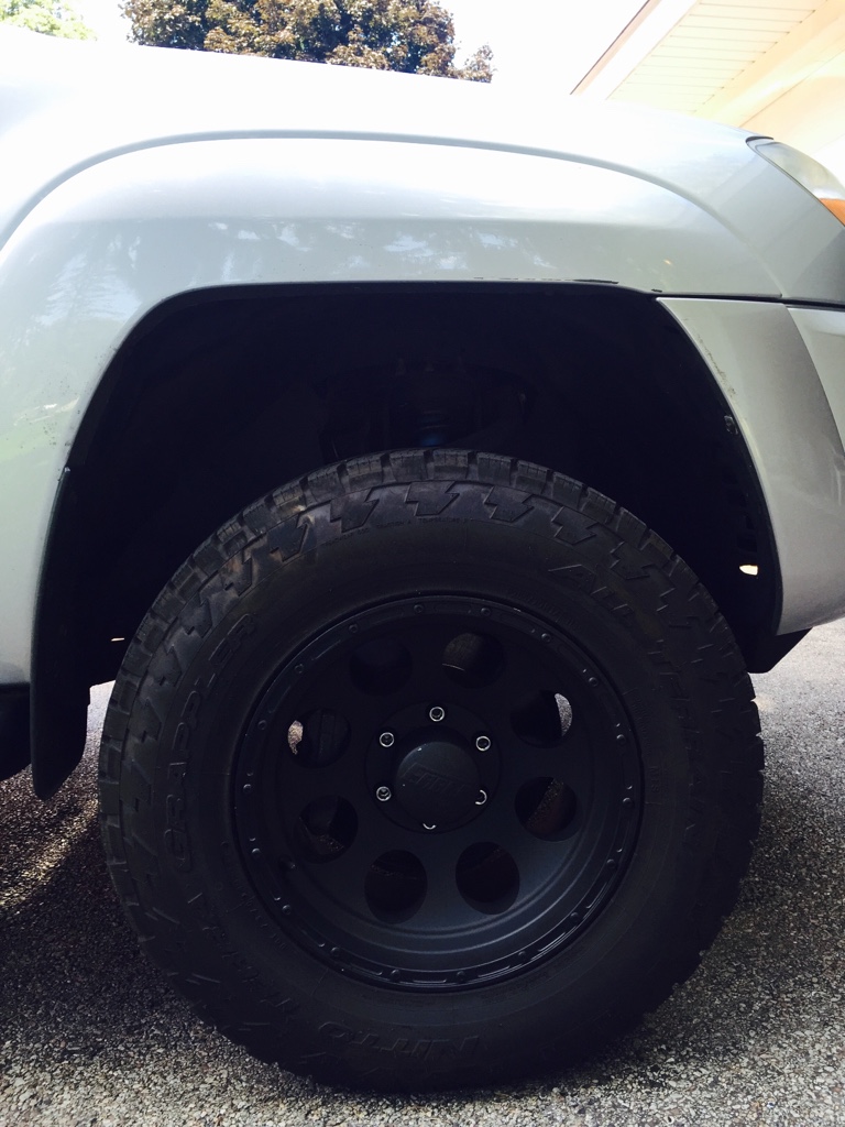

Here is one more picture of mine before I added the Daystar spacers on the rear. The wheel gaps are pretty even but the whole rear of the truck looks low. Compare this with the picture I posted above and you will see the difference. This was FJ springs only on the rear with Taco springs and Toytec spacer on the front.
