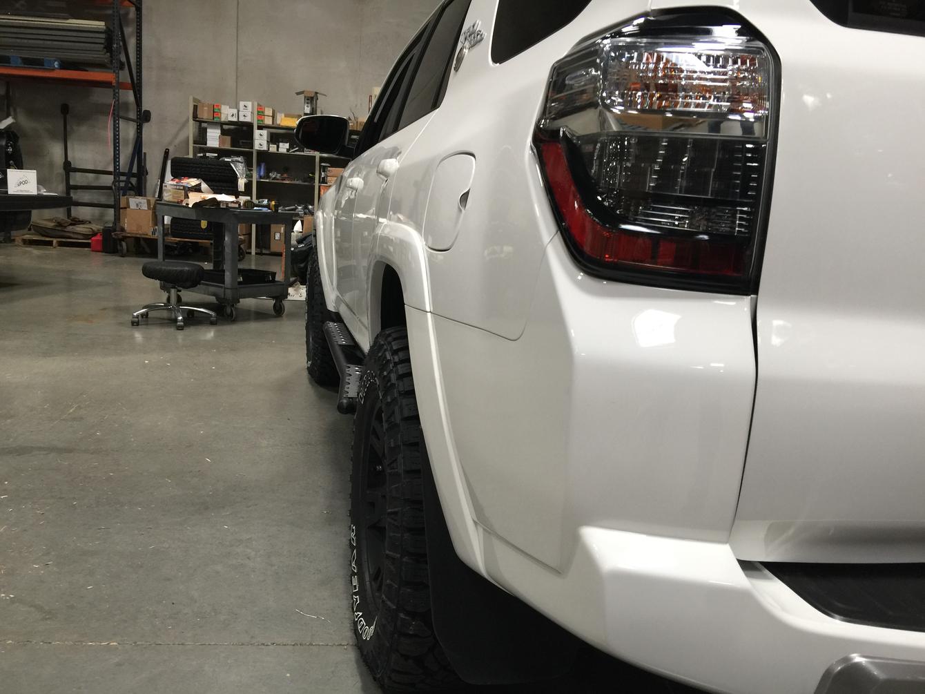

Seems like there are so few of us on the Wrangler Duratracs. I feel like we need to form up a splinter group.
As of tomorrow, our setup will be 265s on BORA 1.25" spacers. The rig is a non lifted 2017 TRD Off Road Premium with KDSS. The spacers are to satisfy the visual gap from the C4 Fab slider kickouts we mounted and I've seen some of you run 265s this way so were going for it.
Were going to take these from flatlander Illinois out to the Rockies and back in December. I recall my winter break commutes from decades ago back and forth to Colorado State from south of Chicago and some times the parts in between were the most difficult. There will be mountain passes and if the weather permits some easy trail exploration outside of Breckenridge and Fairplay, maybe.
I started this thread to provide foul weather and long tour feedback on this setup, since few of us keep the truck stock in the suspension area or run stock sized Duratracs. I'll post before and afters of the setup after the installation tomorrow, and post results here as we go on our first adventure with the rig.
More goodies are going on thanks to #Chitown4x4 that I've listed in my sig.
Cheers!

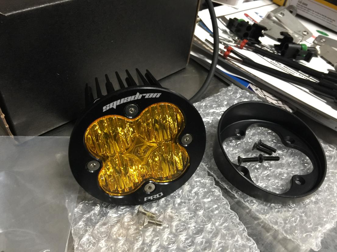

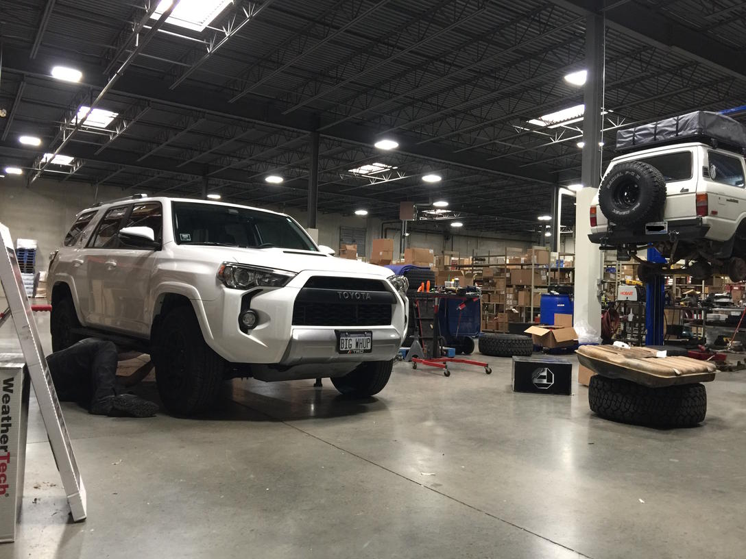

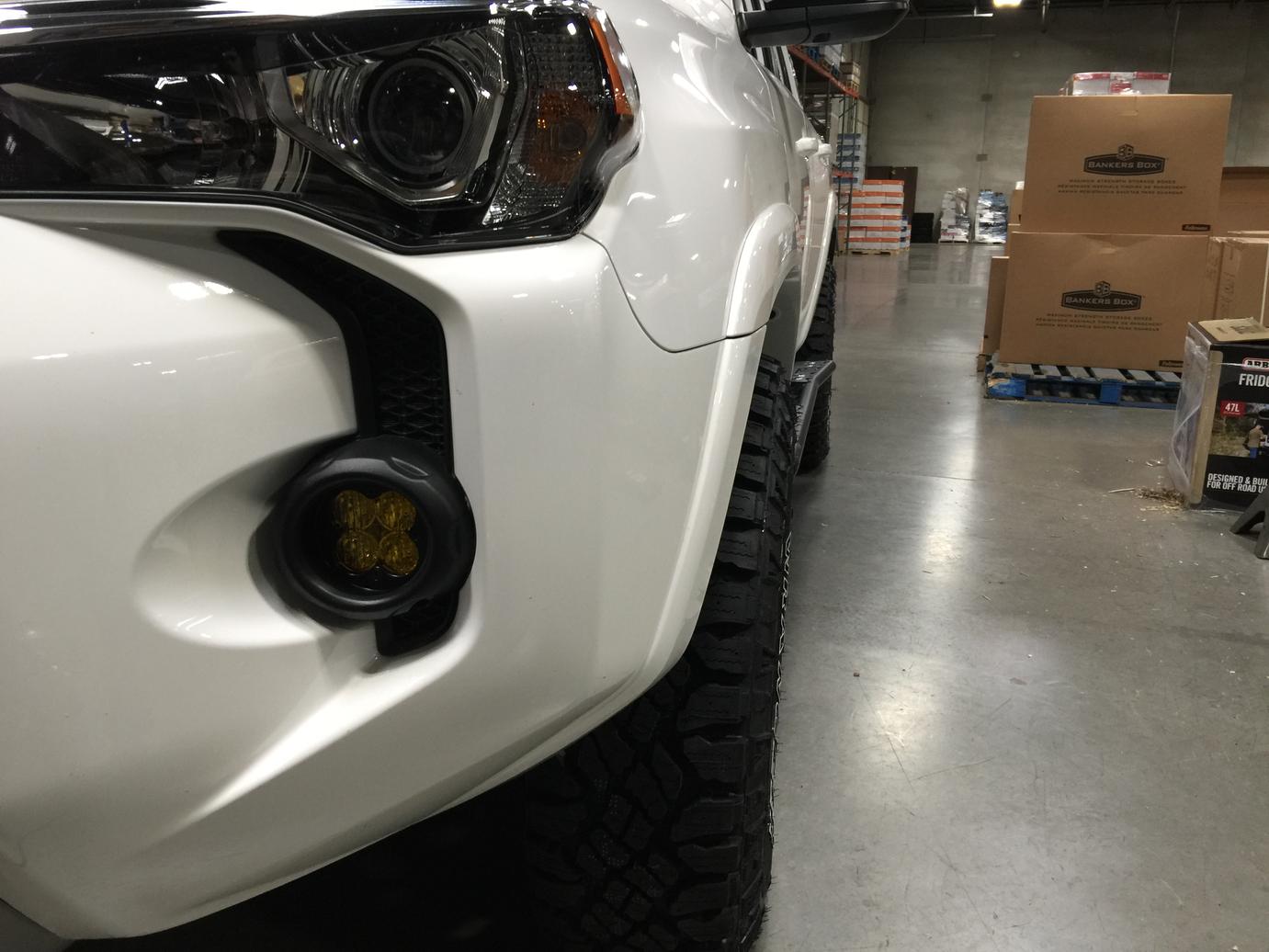

The Results!

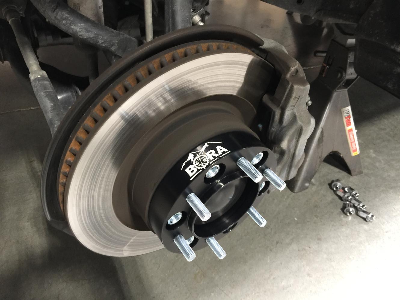

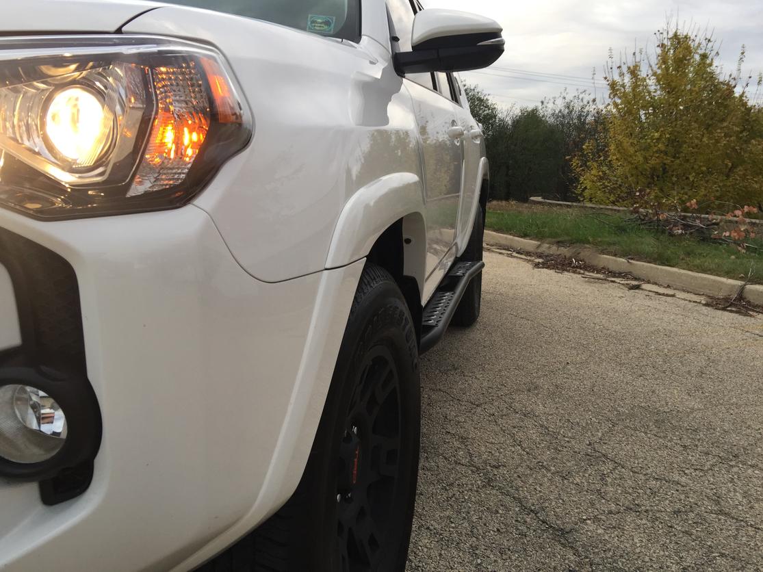

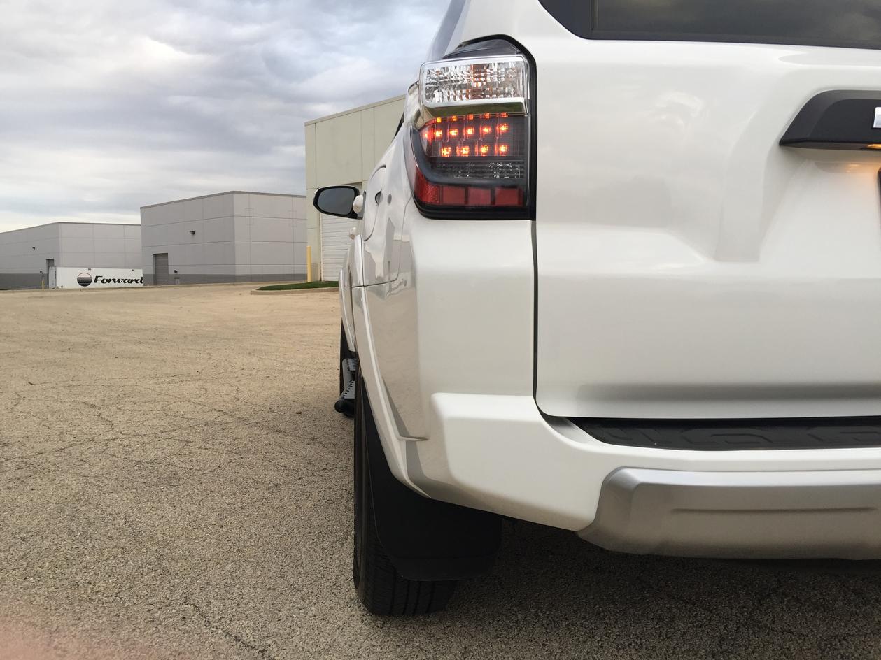

So here is the follow up to the install with pictures. I love the new beefy look of the truck. The spacers really make the tires fill the wheel wells, and that comes at a price. The mud flaps had to come off and the front bumper needed to be trimmed after the fender liner was re drilled and moved forward. Rick made quick work of it so there is no rubbing at all when driving aggressively on the street, lock to lock both directions. I think there is a way to modify the mudflap, I will look into it when I have some time as I had to jet outta there for an appointment.

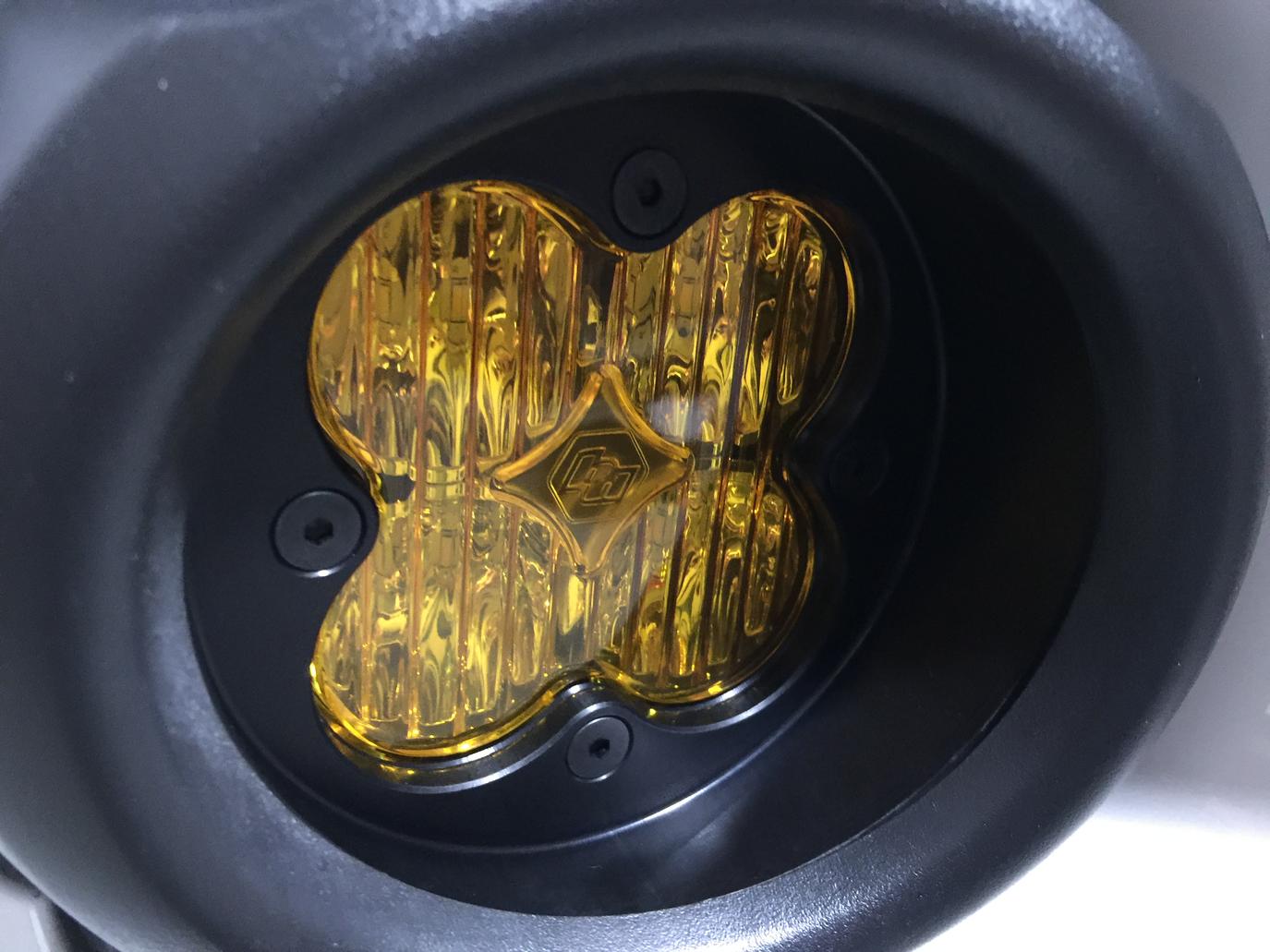

Before shots of the Duellers, the BORAs, and the BAJA Pros.

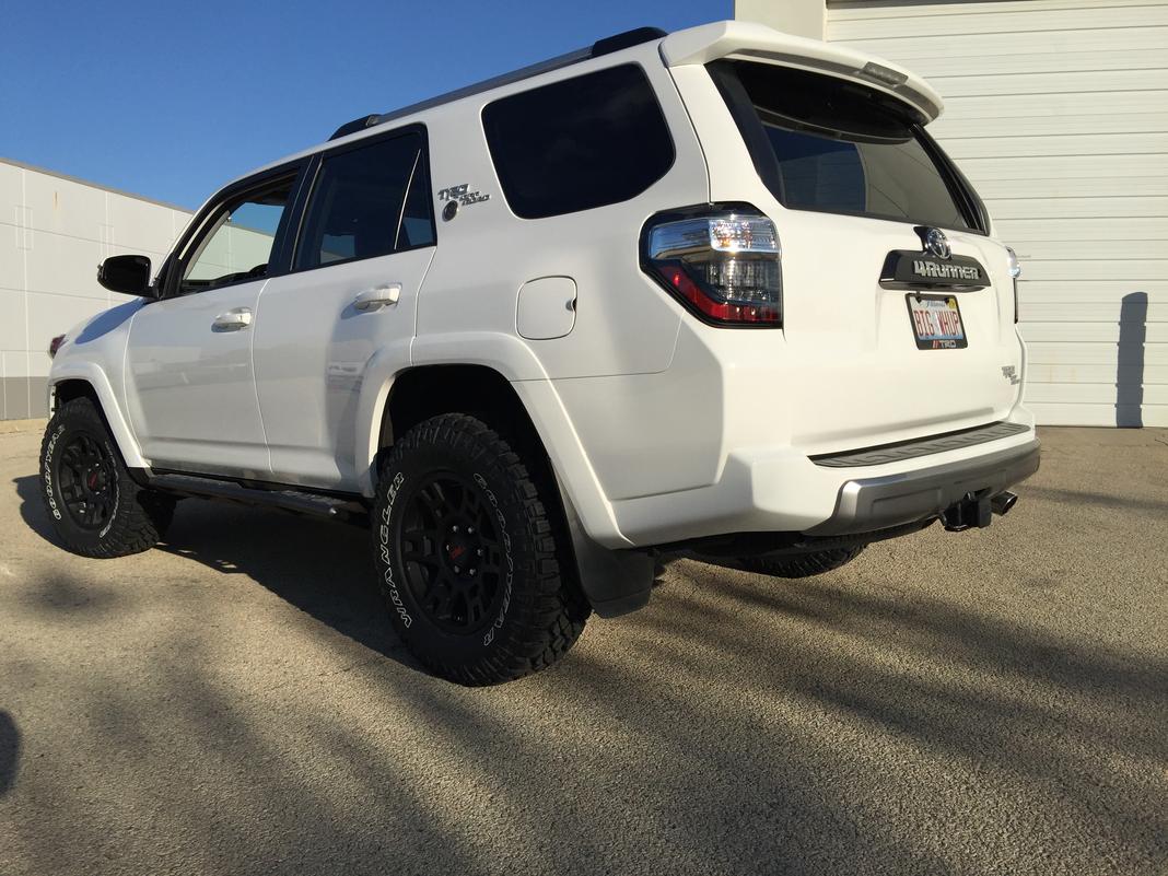

Here are the Results part 2

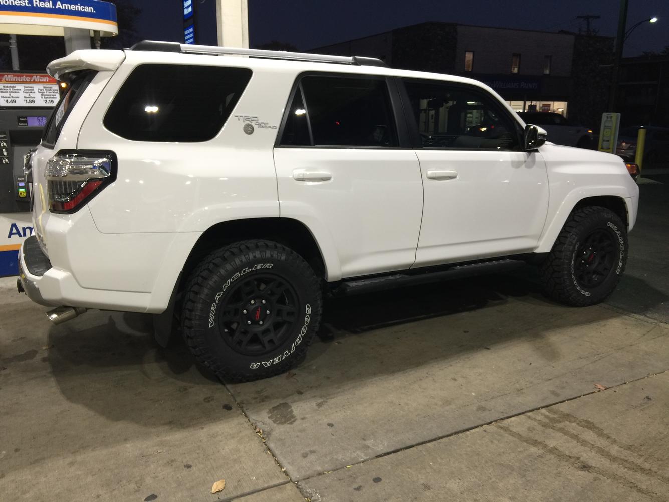

Here is the final fitment. Looks great, tires are quieter than expected. They are all at 35 lbs and I am thinking of taking them up to 38 across the board to see how they feel. Very plush right now and I agree, the sidewalls "feel" soft. Love the look of the OWLs with the white truck. Let it snow!
BTW, BORA makes a .75" spacer that MIGHT mean no trimming but we didnt fit them to see.
