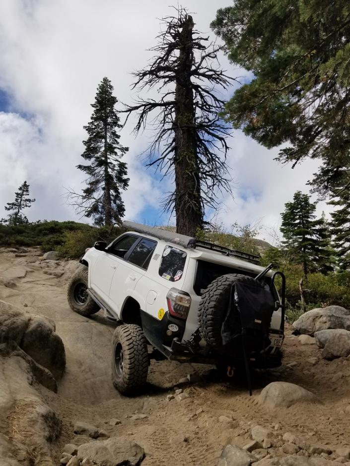

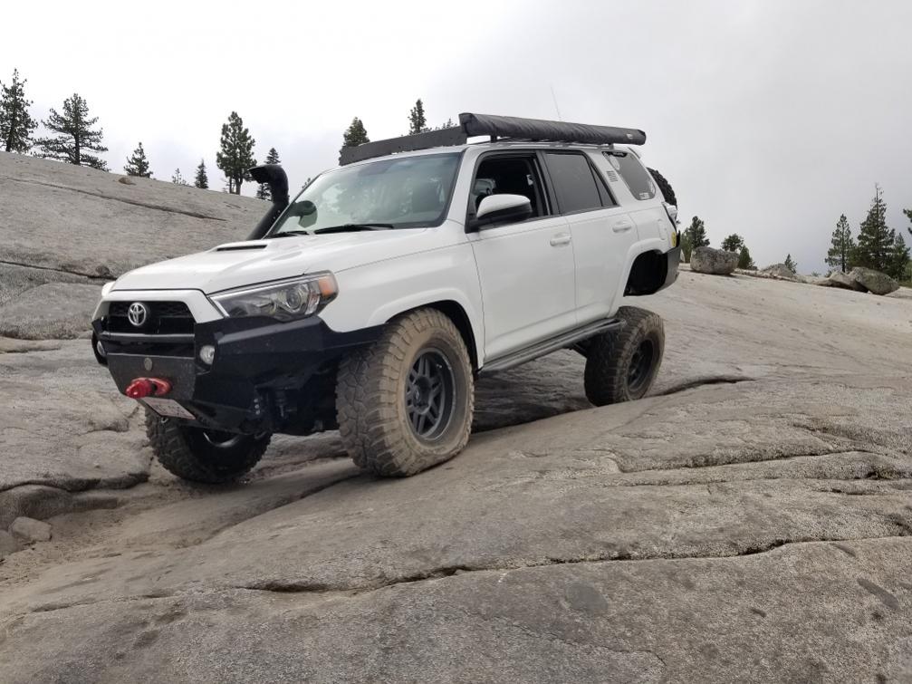

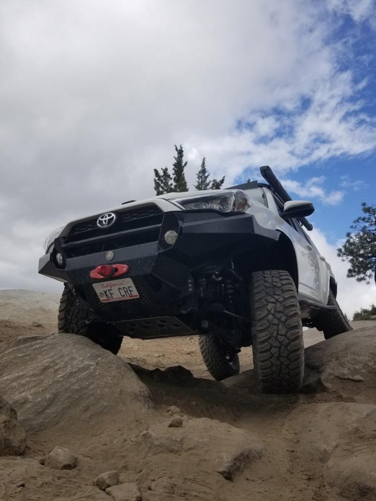

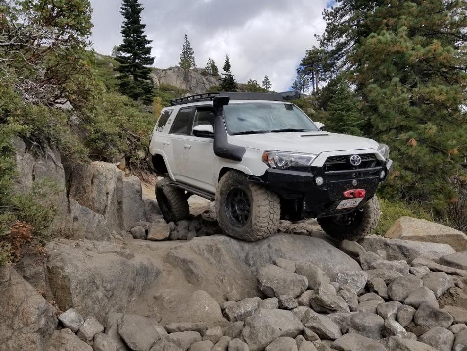

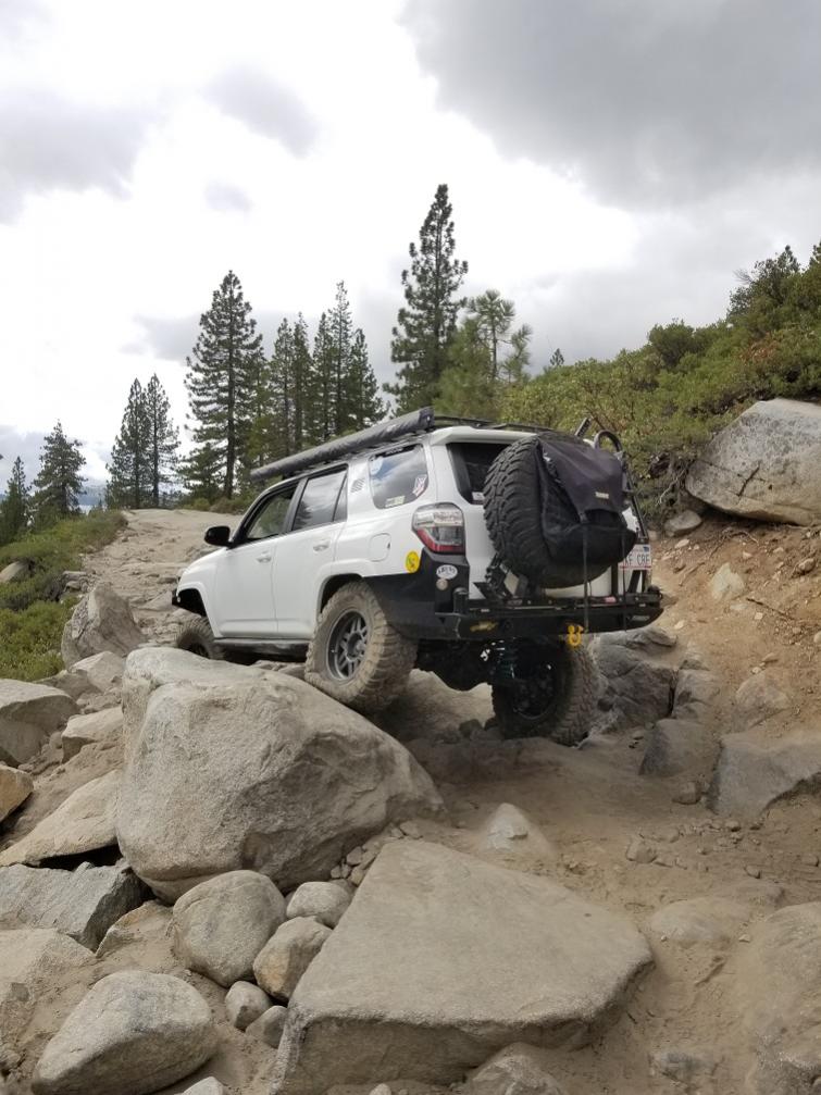

Last fall, I ran a portion of it from Loon Lake to Little Sluice and then back. It took all day to make that trip, probably took the better part of 4.5 hours to get to Little Sluice. Let's put it this way, I used every piece of armor that day, including the front bumper. Sliders were the most used, not used sliding, but moving boulders with them trying to squeeze through. The only carnage was a busted tail light from dropping the ass off a ledge and hammering the rear bumper, which busted the tail light.
It is doable, just make sure to be prepared with the proper supplies, spare parts, tools and time.
