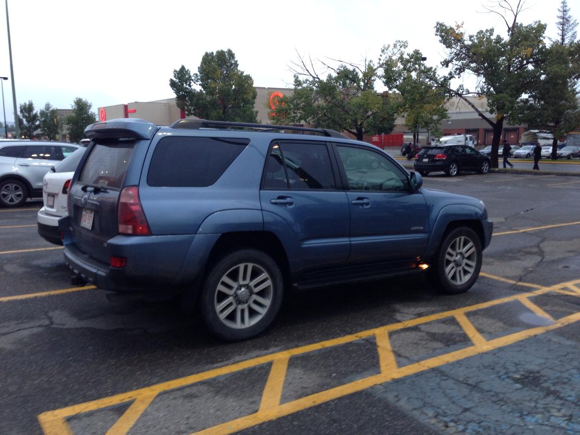

I've been running the limited 18's with 275/65r18 General Grabber AT2 and was originally running it with FJ springs and cornfed 2/1 spacers and it worked out really good!
I was running the Limited 18s with stock tires and no lift:
Then I upgraded my wheels to Ultra Gauntlet 18s w/Cooper Discoverer A/T3's 265/65R18 & put a Daystar kit:

20s here, no lift zero rubbing. You're not going to have any problems at 18" buy what you like and don't worry about it

18's also, with a Toytec 3" and Bilstein 5100
I'm running Cooper Zeon LTZ 285/60 and the American Racing ATX Artillery
(18X9, 4.56" backspacing, -12mm offset)
Yea i think -12 mm offset would be best, thats what the gauntlets have as well.
Check out the XD Monster wheels, I was looking at those but went with the gauntlets since a member was getting rid of his.
