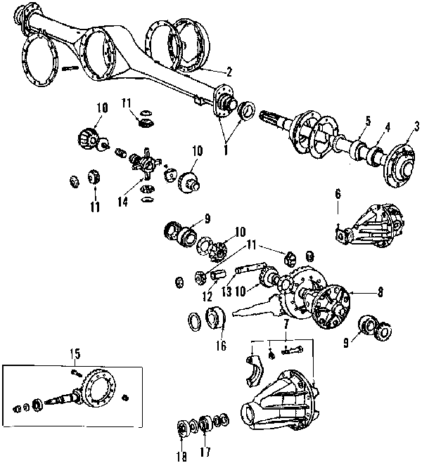

Update
Got to a Toyota service center today:
Rear Differential assembly - needs to be replaced
Rear Passenger side wheel bearing - needs to be replaced
All four tires - need to be replaced
Toyota to cover everything but the tires under 5/60 drivetrain wty (I'm over by about 700 miles).
Free loaner car to boot.
Could have been a very expensive day.
The rear wheel bearings have been a bit of an issue with previous gens but I'd be interested here what the shop says regarding the possible reason for the diff. That's very unusual IMO. I've had 2 previous 4Runners, a 2nd gen that I sold at 205,000 miles and a 3rd gen I sold at 152,000 miles and neither had a rear diff issue nor had I heard much of premature diff failures on other Toyota forums.
I'll let you know what they say.
Also had a replacement of Hub & Bearing FR at 34k miles.
All fixed. Running like a champ. No explanation for problem.
(1) Carrier Assy, Dif - replaced
(1) Gasket, Dif - replaced
(6) Gear lube
Align four wheels.
New tires.
Feels like a new truck.
Props to the dealer for covering everything but the tires and alignment under warranty (I was just over 60k).
