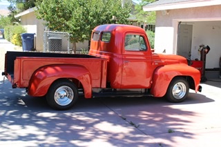

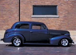

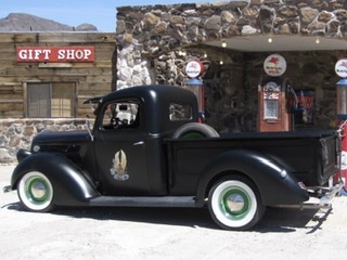

Once upon a time cars looked cool and rake was desired. (not my pics...)

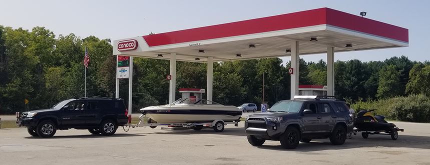

This is why I did not level mine when I lifted it. A bit of rake during daily driving helps with visibility, and when I do tow (which sure, isn't super often) I am almost perfectly level. Picture of me towing a boat for example, next to my buddy's stock 5th gen towing a jet ski. Neither leveled, but both level when towing.
