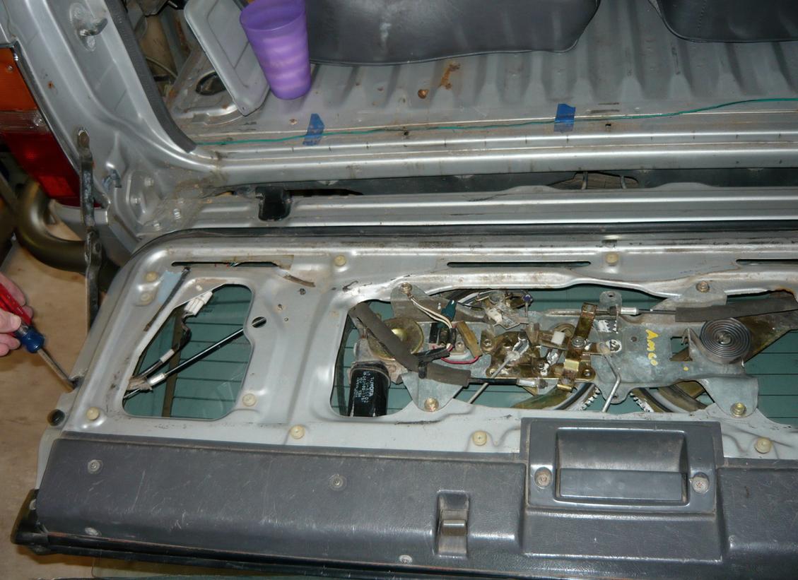

Take off the access and u can get to everything.
if you're inside with the window up.
you can roll the window "up, while the gate is down, but you have to lock the latches. i use a screwdriver, to push each side in until it clicks.
you will want something to support the glass, otherwise it will fall.
and, dont forget to pull the handle, and open the latches before you try to shut it.
Yeah pretty easy to get to everything. I only had to put the screwdriver in the driver side to get mine to operate with the door open. Like mentioned above, make sure you support the glass.
oh yeh, my bad.
i should know better, ive been in there a ****ton of times.
infact, so often, i dont even have the cover on...its exposed right now...
