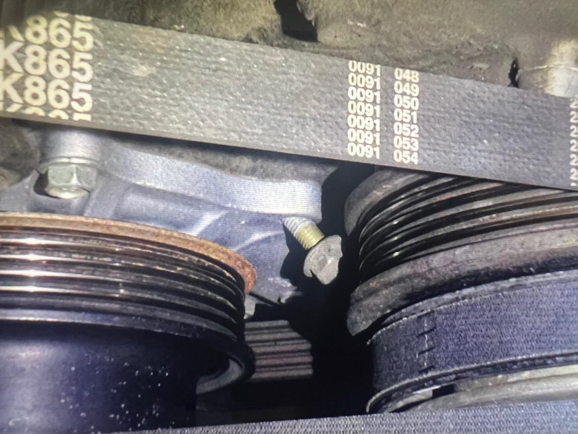

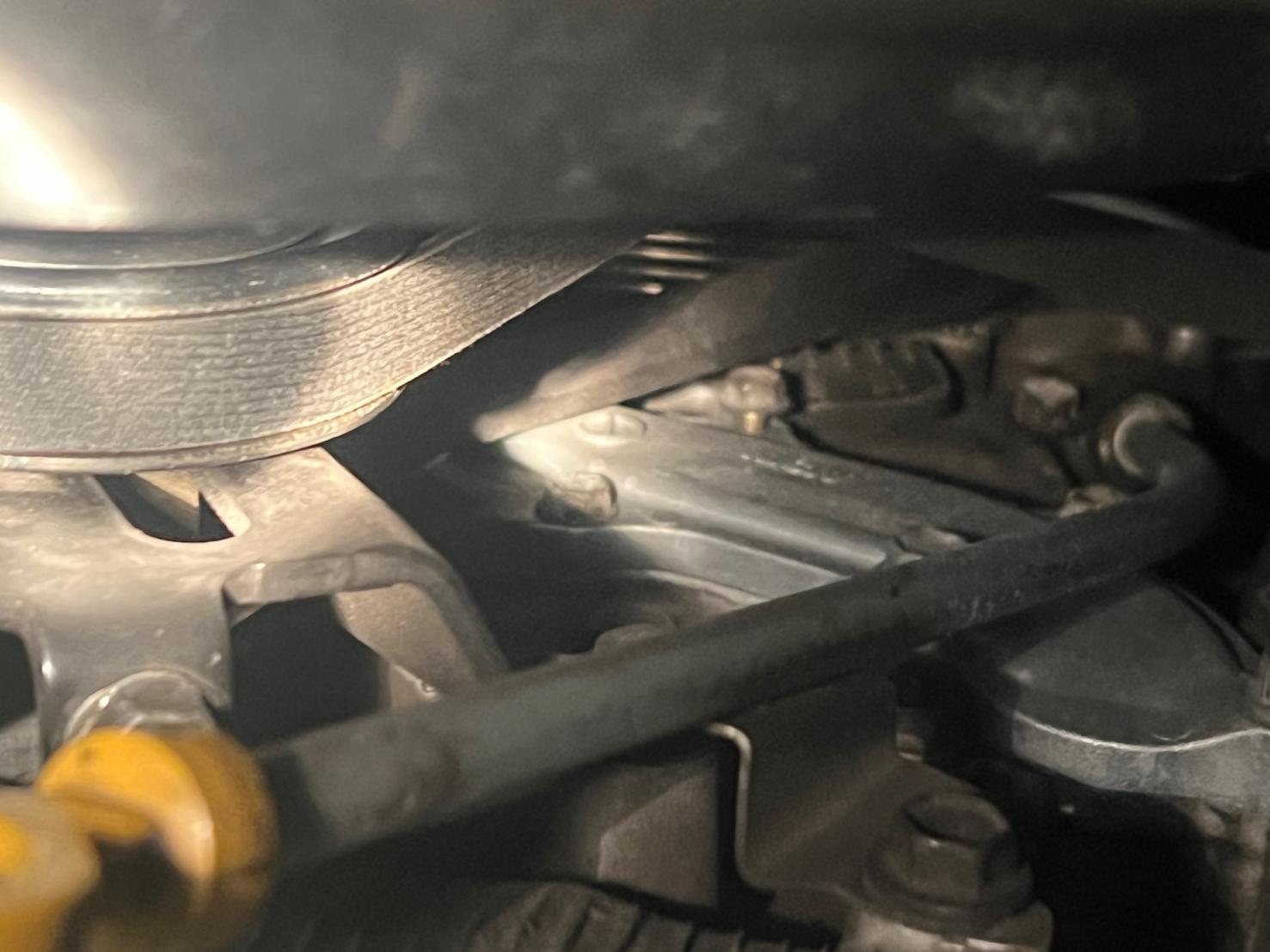

I was doing work on my car today, and I noticed some extremely concerning developments. My water pump had 2 bolts basically hanging out, one was held in with the belt the other was literally dangling.

It's scary how close I got to disaster, those photos show the bolts in the state I found in, I hadn't touched them. I'm not so full of myself that I wont say that I couldn't have missed one, but I do remember going around with a torque wrench double checking. If they were loose they weren't hanging out because I was in that area a lot trouble shooting squeaking belts and power steering pump soon after.

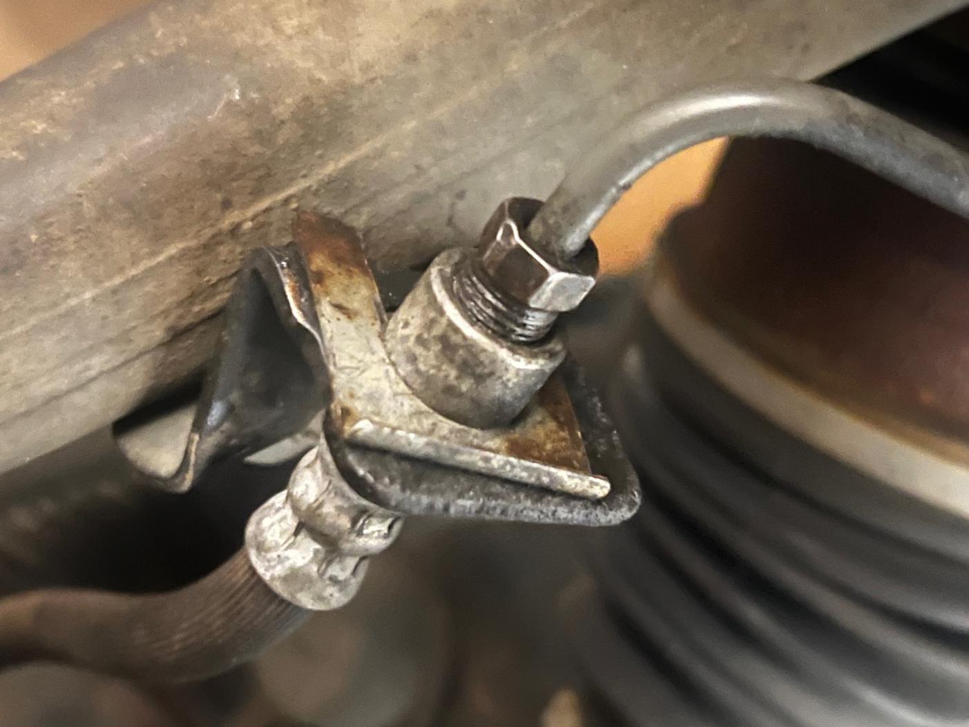

Should I loosen the brake hose all the way and make sure the fitting is clean (which would require rebleeding). I'll snug them up first, I don't know how much force I should put into these fittings. I took a photo of the leaking hoses, the other hose is leaking on the other fitting coming from the brake line.
I hope I didn't cross thread the fitting, that would royally suck. The 1st photo is a photo of a photo I took on my other phone.

WHOA! Dude buy a lottery ticket you lucky SOB!
Ive never had bolts back out like that. I was going to suggest a TQ wrench, but you had one.
Like I said before, probably accidentally skip over them, while torquing. Sh it happens and luckily you caught it in time. I'd say worse that could have happened was throwing a belt. Probably just bounce off the pulley and end up on the road.
I'd tighten down those brake fittings. Clean with brake cleaner or water and let dry. Drive a bit, and recheck.

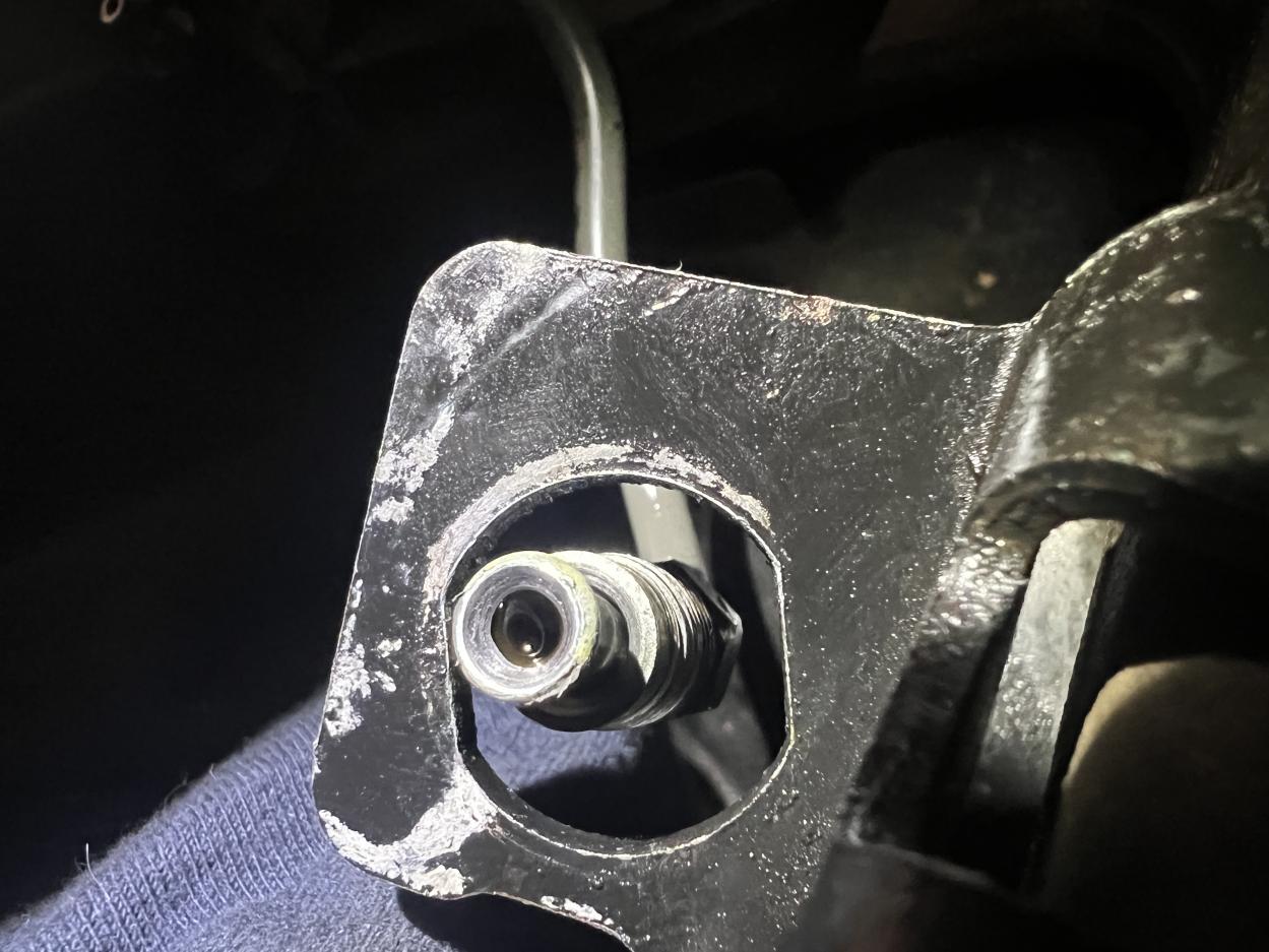

I tightened down the left brake hose and it started leaking even worse. I removed it and the outside of the flare had some sort of paint flaking off. Like some sort of coating. I don’t know what it’s for.
Will this be a useable fitting once I clean it up? What should I do about it?
I haven’t even started on the other side. Brake hoses aren’t one time use things right? If I have to remove one I can put it back on.

Hmm they flair looks a bit roasted. Its paint is that grayish brown coating on the brake line. How does the rubber hose's inverted flair look like?
The hose looks okay, but I tried retightening them both, one is now working for now, but the one in the photo is still dripping brake fluid.
Do I have to replace it?
Have to replace it or re-flare it..As its is not sealing properly.
