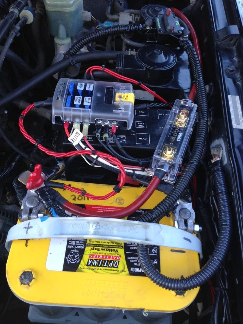

Btw OP, here is what I use for ALL my non-factory electronics....
* Blue Sea Systems Fuse Block Ato 6 Circuit with Ground

Damn, crazy pics I'm sorry to see those! Also that's one of the best "poser shots" I've ever seen. Need to find me a car to post up on hahah. Glad everyone is ok. Im experimenting with the 4wd to see if I can get another reaction (hot ignition) to follow the wires back to the source. That fuse box looks handy! I might need to pick one of those up myself.
