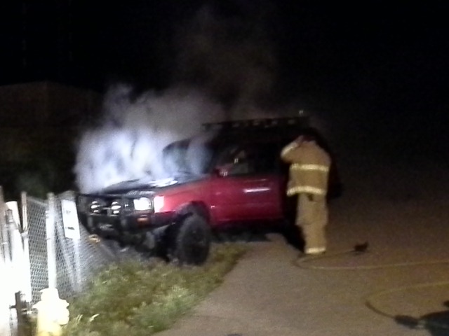

I lost my last '98 to a similar issue. I had noticed the key/switch had been getting very warm for a couple weeks. Truck was 5speed, the starter engaged its self while parked for the night. The starter actually pushed the truck 50 feet before it ran into a fence. The security guard at the track saw it happen, and said the engine compartment was already on fire when it started moving. It was almost impossible to track down the cause due to the fire damage, but the only damage inside that we found was the wiring from the firewall to the starter switch. Not sure if it was internal switch issue, wiring, starter relay, or something completely un-related, but I wouldn't wait on getting it diagnosed.
