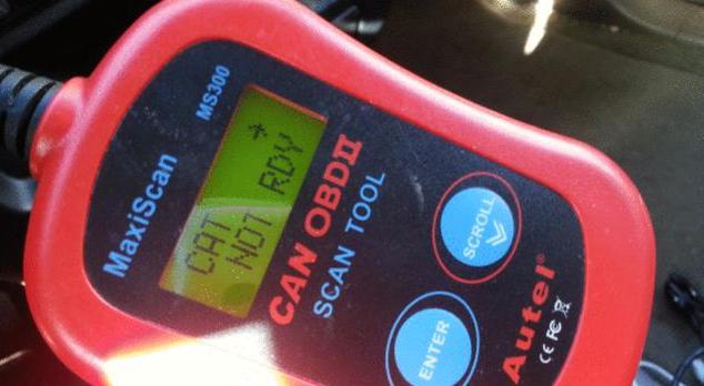

Why would a catalytic converter monitor consistently (for weeks of daily driving) not be ready for a smog test?
Two weeks ago I went to a California smog test station, and they said my 5-speed '97 2wd 4Runner with 150k miles (with original cats and oxygen sensors) would fail because the catalytic converter monitor wasn't ready.
They said drive 15 minutes on the highway, and it would become ready, but, it has been over two weeks and it's still not ready - and I've driven between 50 and 60 steadily on the highway for hundreds of miles.
All other registers are full, and there are no pending or set codes.
I'm stumped, and need your experienced advice:
What could possibly make a catalytic converter register never get ready?

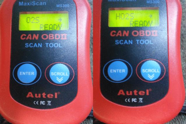

When I googled, I found that some people tried replacing oxygen sensors, but, mine seem to be fine (so I wouldn't replace them unless/until they indicated they're actually bad).
If the detail helps for you to advise me, there are apparently two different oxygen sensor monitors (02S and H02S), but both are fully set and there are no diagnostic trouble codes whatsoever.
So, with the oxygen sensors ready, and all other monitors full, why, after weeks of driving on all types of typical conditions, would the catalytic converter monitors not show they are ready?

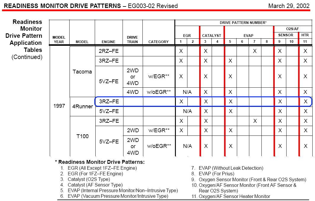

I converted the PDF TSB TheDurk kindly provided to JPG, and I will post the relevant page for my 1997 5-speed 4-cylinder 2wd 4Runner once I figure out which test I need to run to set the catalytic converter monitor.
EDIT:
Page 4 of the document shows the following chart for our vehicles, with my 4Runner type circled in blue, showing the relevant test to be "Catalyst (O2S Type)".
So, I'll look deeper into the TSB to find what specific test sequence to run, in order to test that.

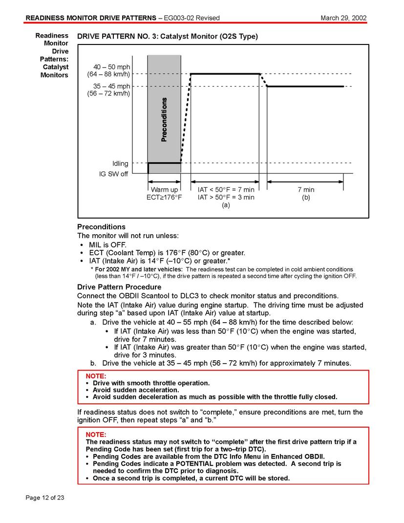

I think the relevant page for my 4Runner is page 12 of the beautiful document TheDurk kindly provided.
I also noticed that the temperature at the start is DIFFERENT than what the California BAR technician stated, so, once again, I'm confused.
But, I tend to think that Toyota knows the 4Runner better than the California BAR, so, I'll try to decipher exactly what I need to do from the following transcription.
Preconditions:
The monitor will not run unless:
- MIL is OFF.
- ECT (Coolant Temp) is 176°F (80°C) or greater.
- IAT (Intake Air) is 14°F (–10°C) or greater.*
*For 2002 MY and later vehicles:
The readiness test can be completed in cold ambient conditions (less than 14
°F / –10°C), if the drive pattern is repeated a second time after cycling the ignition OFF.
Drive Pattern Procedure
- Connect the OBDII Scantool to DLC3 to check monitor status and preconditions.
- Note the IAT (Intake Air) value during engine startup.
The driving time must be adjusted during step “a” based upon IAT (Intake Air) value at startup.
a. Drive the vehicle at 40 – 55 mph (64 – 88 km/h) for the time described below:
If IAT (Intake Air) was less than 50°F (10°C) when the engine was started,drive for 7 minutes.
If IAT (Intake Air) was greater than 50°F (10°C) when the engine was started,drive for 3 minutes.
b.Drive the vehicle at 35 – 45 mph (56 – 72 km/h) for approximately 7 minutes.
NOTE:
Drive with smooth throttle operation.
Avoid sudden acceleration.
Avoid sudden deceleration as much as possible with the throttle fully closed.
If readiness status does not switch to “complete,” ensure preconditions are met, turn theignition OFF, then repeat steps “a” and “b".
NOTE: The readiness status may not switch to “complete” after the first drive pattern trip if aPending Code has been set (first trip for a two–trip DTC).
- Pending Codes are available from the DTC Info Menu in Enhanced OBDII.
- Pending Codes indicate a POTENTIAL problem was detected. A second trip isneeded to confirm the DTC prior to diagnosis.
- Once a second trip is completed, a current DTC will be stored.

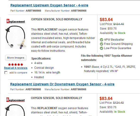

You only want the OEM Denso sensors. You don't have to buy them from Toyota. Amazon or Rockauto.com usually has the best prices. Get the Denso part number here:
Find My Part | DENSO Auto Parts
At your mileage on original sensors I would just change them. They don't owe you anything; they are past end-of-life. If the front sensor is the problem, changing it probably will improve mpg as well.
changing [the front sensor] probably will improve mpg
Thanks. I wasn't sure what positive effect they'd have, so, I appreciate the insight.
Thanks for that advice as I don't have the experience to make the brand decision on my own.
Thanks for that search tip, and the OEM brand name.

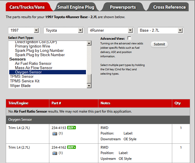

Going to that URL, it seems the two part numbers I would want are:
I'm googling right now to see how best to TEST the sensors, since I rarely replace parts without first attempting to diagnose that they're actually bad - unless - it's the only option left.

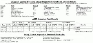

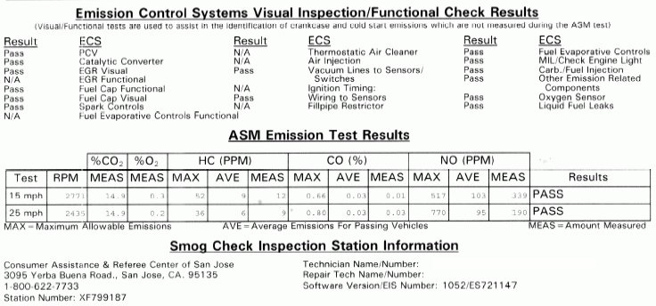

By way of update, I took my 4Runner to the special state-run Consumer Assistance and Referee Center (aka, "smog test referee") today:
Two "referees" spent at least 45 minutes going over the car, inch by inch.
  • They first marked all the scratches and made me sign the waiver.
  • Then they put the OBD scanner on it, and agreed with me that the catalytic converter monitors were still not ready.
  • Then they started the engine, with the hood open, and, with a flashlight, the two of them went through a checklist for at least 20 minutes, visually checking the EGR, oxygen sensors, hoses, oil leaks, and even wisps of smoke were noted, all with the engine running.
    • (They told me the smoke test here doesn't fail the car, but the ending smoke test will fail it.)
  • Then they "kicked" the gas pedal, and wrote down how much smoke was emitted from the tailpipe the SECOND time they did that.
    • (It can fail if it is more than 8 feet of smoke!)
  • Then they drove it onto the dynamometer, and revved the engine up for the low speed and high speed tests.
  • Then, they opened the hood AGAIN, and looked for smoke
    • (This final visual smoke test, they said, could fail the vehicle.)
  • They pressure-tested the gas cap off the car, and they crawled down below and looked underneath for something, I don't know what.
  • At one point, they pulled out a fat brown Mitchell book off the shelf, and earnestly discussed something, I don't know what.
  • Finally, after almost an hour of testing the vehicle, they sat down at their desk, and asked me to pay only for the $8.25 smog test certificate!
    • (The actual test was free.)
It passed smog (without the catalytic converter readiness monitors ever having been set)!
