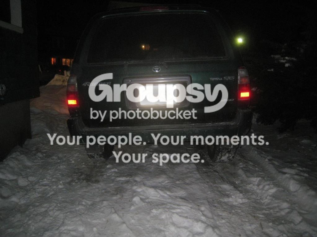

So I noticed some nasty sagging tonight... (sorry for the crappy light in the first pic)

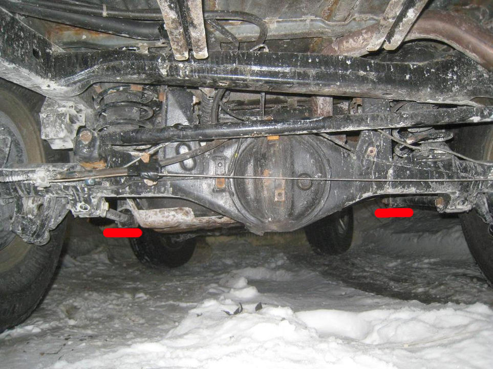

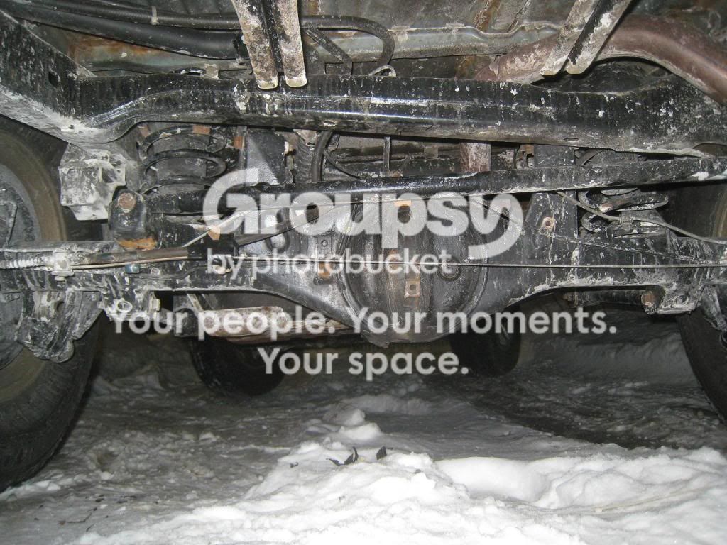

Love that salt...
AxleView.jpg~original
It isn't broken or anything, it is just sagging. I checked all around it for anything broken, but I saw nothing, and no pieces are missing from the ends of the spring.
This morning I went over a speed bump (a little fast, but it isn't a big bump) and I thought it felt a little different after that (I thought I had blown a tire). I didn't think sagging happened immediately, I thought it was gradual.
So I have to drive it to work, which sucks. I guess I will have to call some salvage yards tomorrow to see if I can find one to replace it, or I could just order the OME lift that I have been tentatively planning on buying once it warmed up. I would like to fix this right away, but unfortunately I have long hours this week that I can't miss, and may not even be able to get to a salvage yard until the weekend.
Any suggestions?

I had the same thought, but I crawled under there an checked that both were sitting correctly, and that there wasn't any chunk broken off either, and they both look fine. I can visibly see that the coils are closer together on the drivers side.

The shocks are actually new. I replaced them (OEM) when I did the rear axle swap this fall because they were cheap. I thought about my accident too but I am pretty sure it happened this morning. I can tell that it feels funny and different now.
Look at the forward lower control arm mount...it looks broken. It looks about 2" lower than the passenger side. I dunno, maybe it's supposed to be! It just sticks out to me.
Edit: I just measured mine out in the garage. Both LCA frame mounts are 11.5" from the floor. Since they are welded to the frame, that measurement should never change.
The LCA mounts are connected to the frame, which is suspended by the springs, which are dissimilarly sagging, so it makes sense that the front driver LCA mount would be closer to the ground. Good thought though.

Based on your first pic, it actually seems like your axle is out of line as well as sagged on the left. It looks as if your left wheel is closer to the front of the truck than the right. Of course that could just be funny photo angles. It would be awful hard to change that measurement without a broken LCA.
Have you looked long and hard at your frame? I'd hate to hear that your rust issue affected anything major like that. How's your left front corner?
