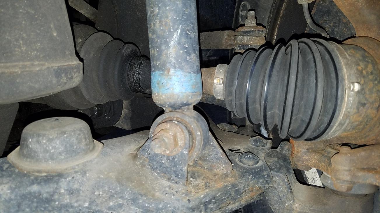

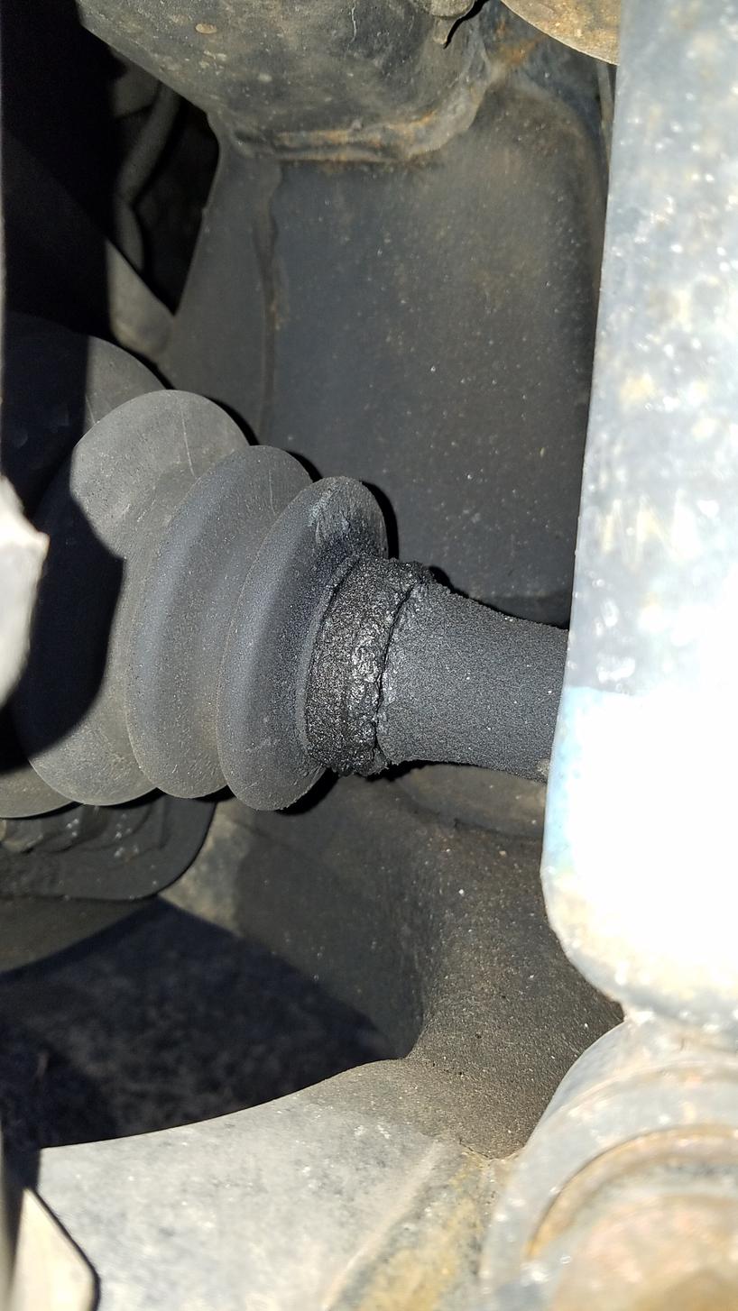

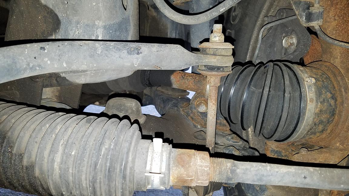

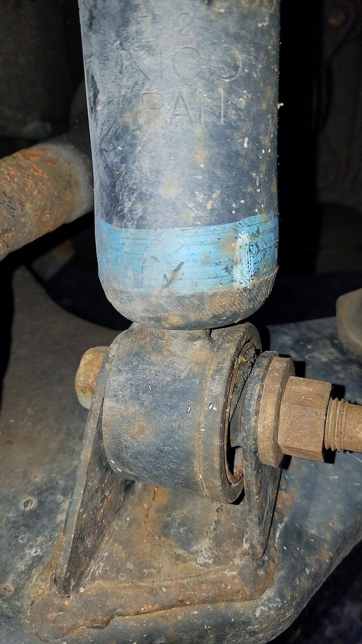

thanks for the suggestion. I went out and took a few pics, didnt feel much play with the tire butall the bushing seems rotted and cracked, CV boots on the back end on both sides has a little builtup on the outside, the boots werent cracked or broken or anything.
