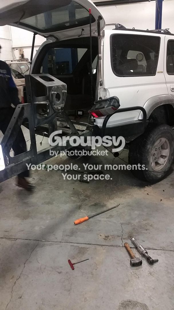

CBI Offroad Rear Bumper with Swing Away Done

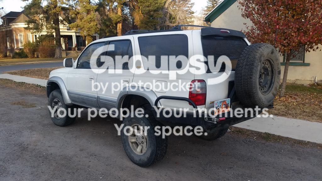

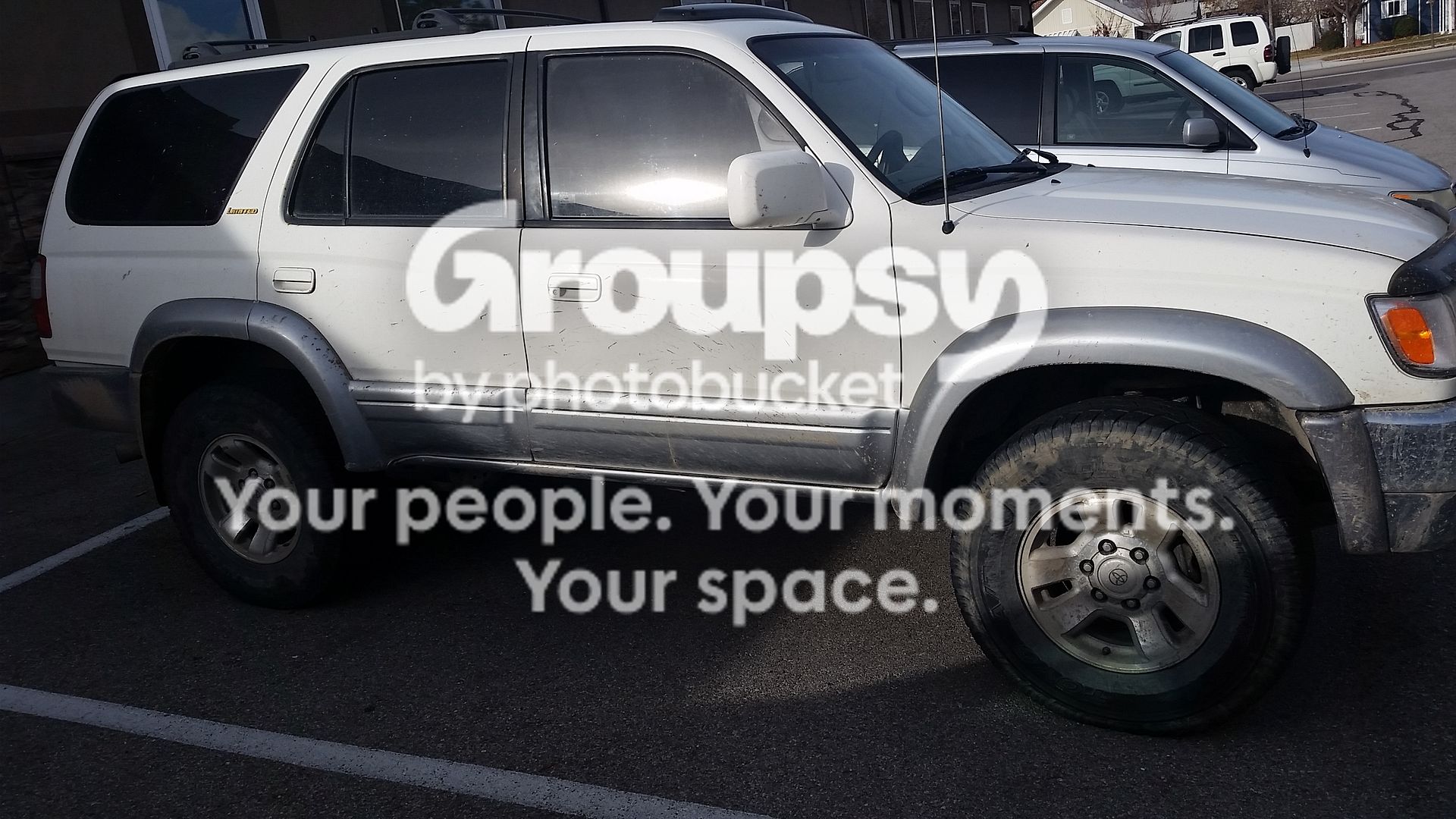

As she sits now:
16079424065_83b913f20d_b.jpg~original
Well. I guess to start off I bought my 98 Limited Runner with 209,000 miles on it towards the end of October. And well, its time to start building it up.

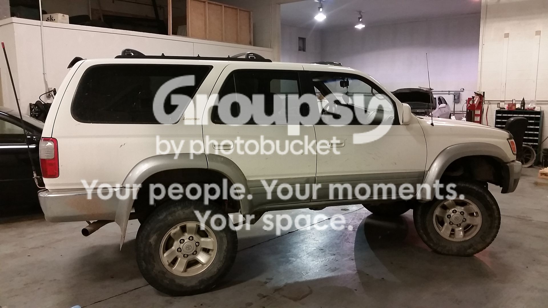

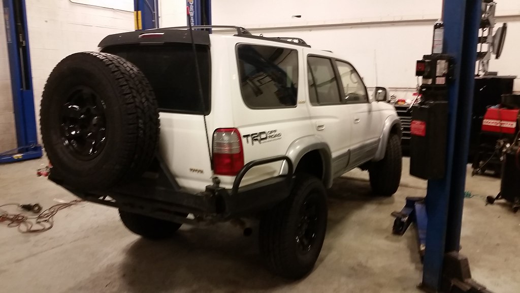

Well i spent today putting my lift on today... Ill post up the actual process when i get a chance... But here are the before and afters just for the teasers of the process haha I put the TRD 1st gen tundra springs in the front with Tundra Bilstein 5100s all the way around and LC 8 wraps in the rear. It is definitely alot bigger than i thought it was going to be.
Before:
20141205_140406_zpse2b70961.jpg~original
After:
20141205_183706_zpsd114f406.jpg~original
So as i guess you can see my front springs came in today and i was able to get everything installed... Well it was definitely an interesting experience.

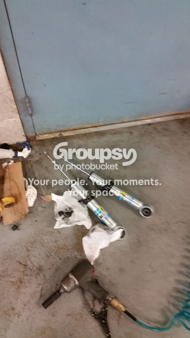

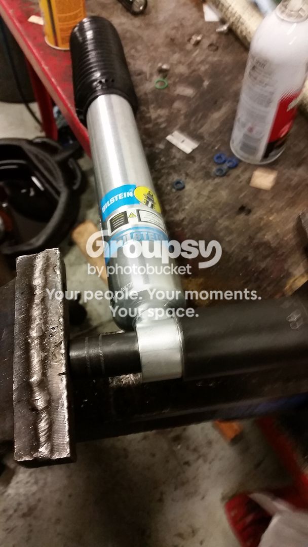

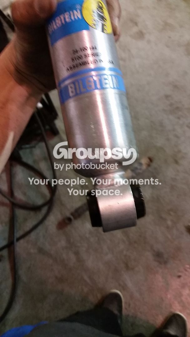

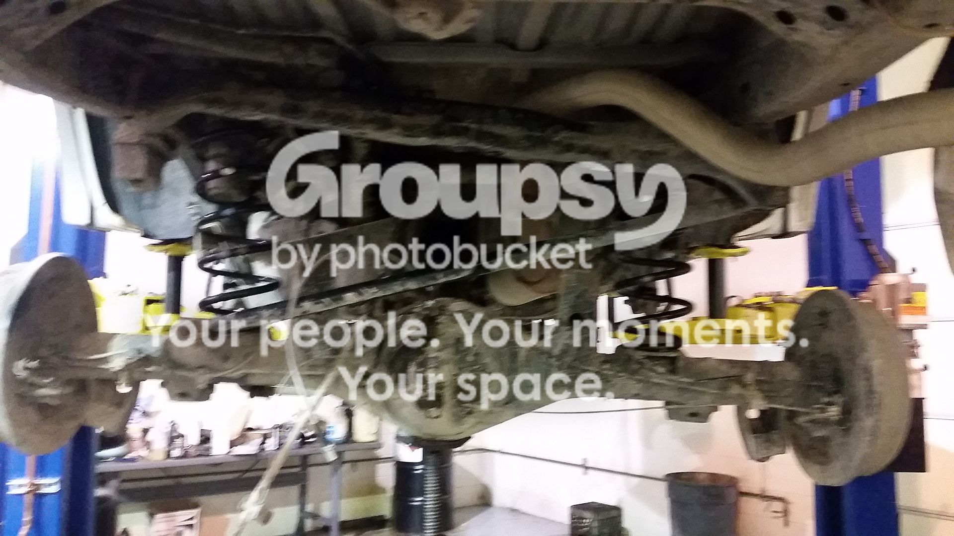

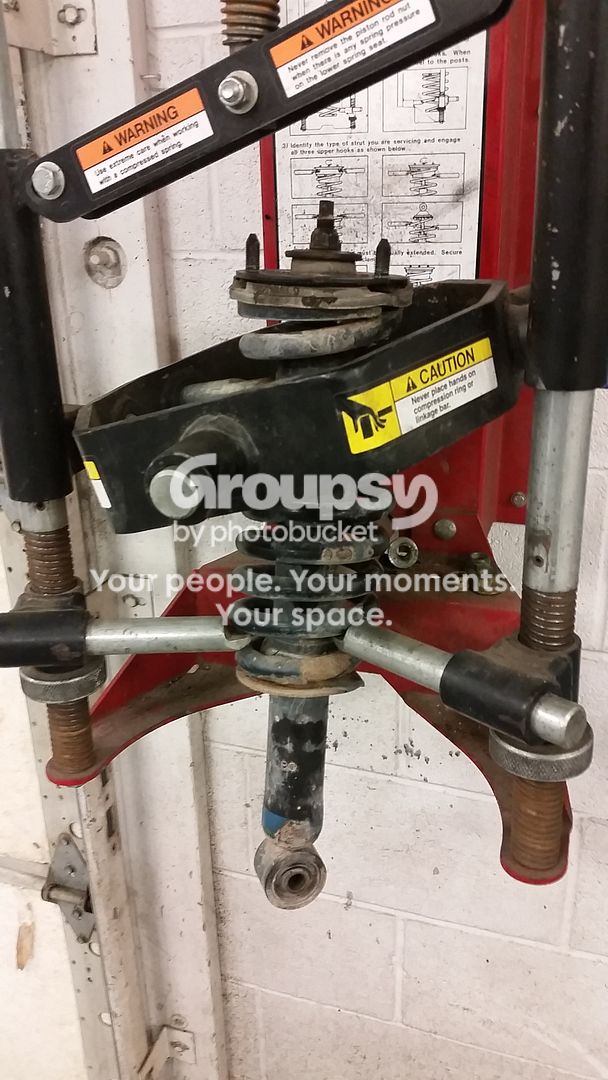

so first thing that had to be done was pressing out the bushings from the rear Bilsteins due to the bushing only being a 1/2" and needing to be 3/4" in order to fit.
20141205_144859_zpswble0jyb.jpg~original
20141205_150454_zpsqlodasj9.jpg~original
Once those were pushed out and the new ones in was able to start removing everything and putting the new stuff in... I went with 1st Gen Tundra Bilstein 5100s all the way around. Only the rears needed the new bushings. And then I put LC 8 wraps in the rear with TRD 1st Gen Tundra coils in the front. (which we will get to soon)
Put in extended brake line in the rear and will need todo the fronts soon most likely before the next wheeling trip.

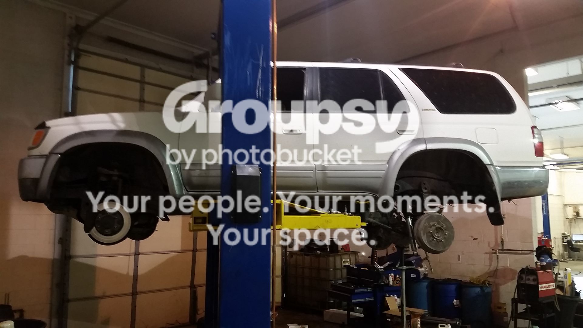

Everything up on the lift
20141205_151654_zpssosgcu4y.jpg~original

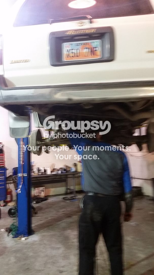

Putting the rear back together
20141205_145912_zpsa4ytr8nf.jpg~original

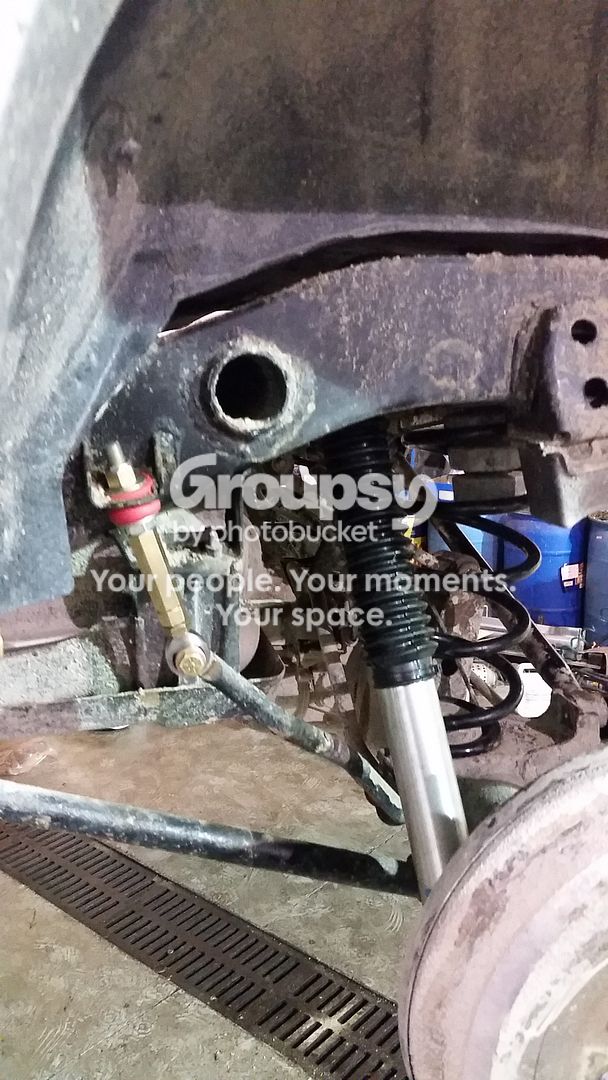

Not gonna lie the rear end was kinda a pain due to putting the sway bar back on and having to match everything back up was a little rough but eventually got it all back together.
20141205_142559_zpsdwe6tnjo.jpg~original
Was also able to put in the new rear sway bar links i got off a member here that makes them. Still waiting on the front quick disconnects. But those will go right in when i get them.
20141205_164120_zps4rg1kglr.jpg~original

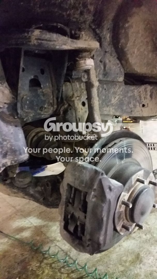

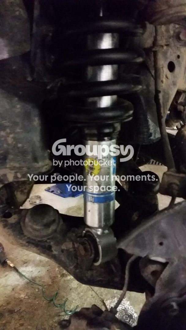

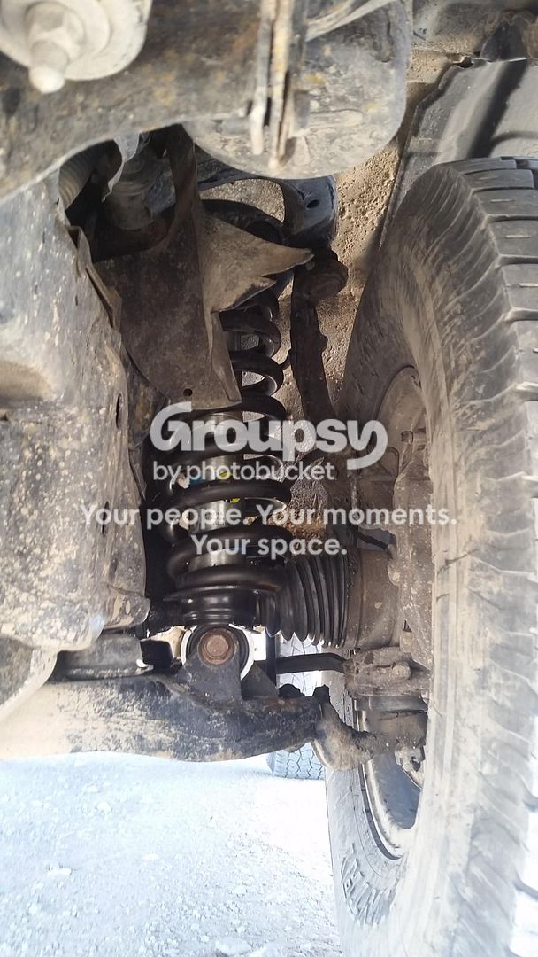

Once the rear was done we were able to get the fronts out and all swapped out as well. ***Quick note on the fronts if you go this route you will want to use the tundra top hat rubber spacer with the stock 4runner top hat as well. I was able to find some great info on the process for the lift on these sites as well
http://www.off-road.com/trucks-4x4/project/project1628.html
http://www.off-road.com/trucks-4x4/project/project1633.html
http://www.off-road.com/trucks-4x4/project/project1629.html
http://www.off-road.com/trucks-4x4/...generation-trail-suspension-part-4-52078.html
20141205_172701_zps6ofifuze.jpg~original
20141205_172703_zps2s5ghs50.jpg~original
20141205_172724_zpsk9quiwpw.jpg~original

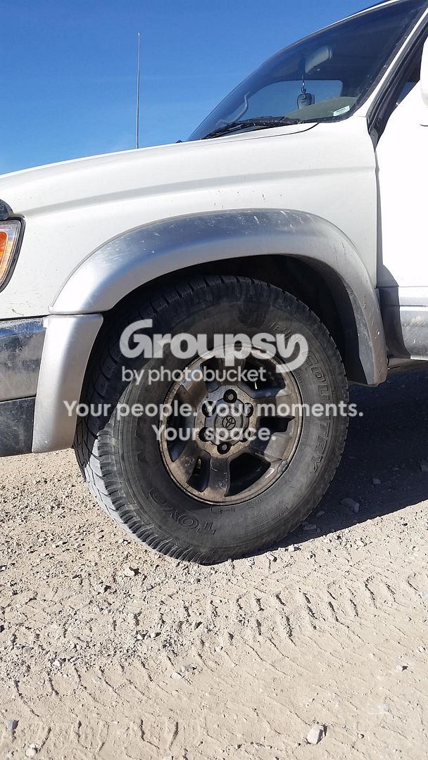

Currently the front Bilsteins are sitting on the middle 3rd perch but after driving it around today after it was installed i am definitely going to be taking it apart tomorrow to change it to the next lower perch since it is way too stiff and it bounces way to much for my liking. then there is some squeaking going on with the rears that i get to figure out tomorrow as well. As we were finishing up my dad decided i should be fine without doing my diff drop today... well long story short im going to be replacing my cv axles tomorrow hopefully as well because the cv boots are both torn wide open now because of the angle they were sitting at. Plus the diff drop, hopefully extended front brake lines, i will definitely be redoing the fronts to change the perch they sit on and hope that they will not be as rough as a ride as they are now then last but not least get the brakes done as i have everything just sitting there waiting parts wise just havent been in the mood to get them done yet... Im really anxious to get this all wrapped up and actually working/running right so i can go and test it out on a trail on sunday so im really hoping that i can get everything fixed on it tomorrow, but i guess we will see what happens.

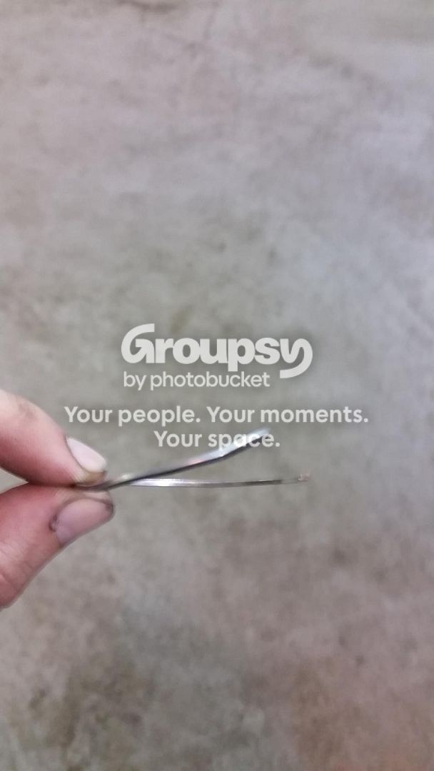

then when i looked underneath it shows
20141208_125732_zpsiqcrjequ.jpg~original
And the snap ring was done for
20141208_155908_zpsnptykkdy.jpg~original
So i limp it back to the shop about 25 miles, go pick up the new snap ring and was able to get everything fixed and back up and going in addition to geting my brakes all done today as well.

So once everything was all finished up i decided to go a little off road up to the top of the mountain that is just behind my house and everything felt pretty good so hopefully on Wednesday i can go ahead and take off the sway bars and go out on the trail and really be able to test out the suspension to see how it handles on the trail for me... I am really hoping that the fronts will hold up because even on the bottom perch on the bilsteins they still feel pretty stiff with using the TRD tundra coils. Hopefully it all settles just fine and i dont run into more issues. Considering how stiff the front is im also trying to decide if i want to test out my stock runner coils on the bilsteins and see how those feel and if they will hold up. But if these current springs keep causing problems i may end up going back to the stock springs until i can find something else to use in the mean time that will handle a little better.
