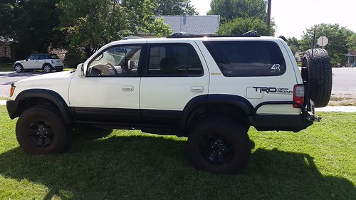

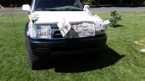

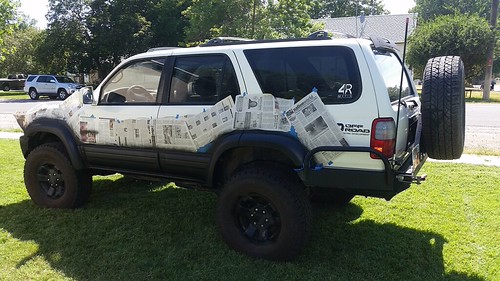

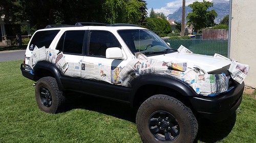

After that i was then able to go ahead and tape off the truck and get the grey rocker panels and flares all painted and can honestly say i love the new look of the truck!
Before:
After:

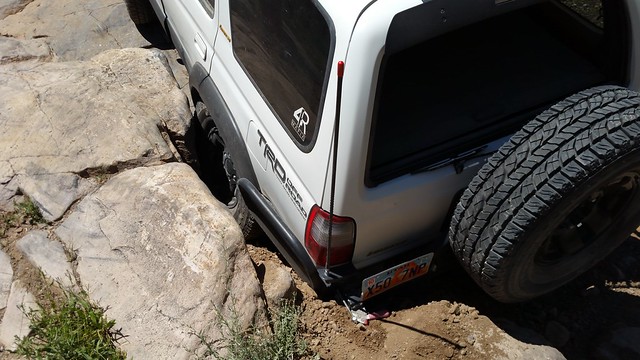

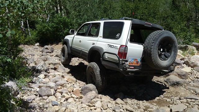

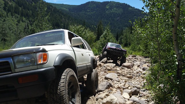

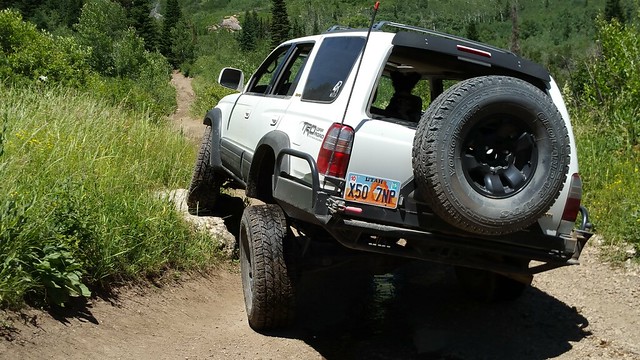

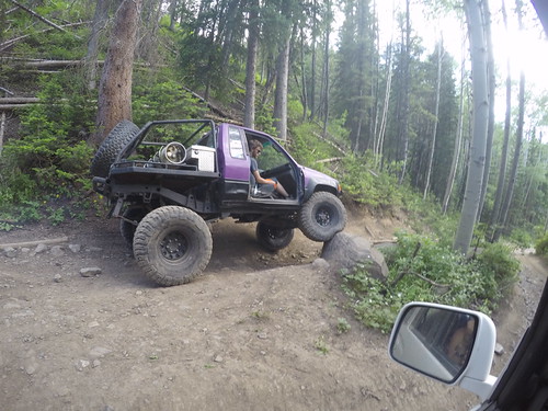

Wow. Well its been awhile since ive been on or updated anything on here haha. But been fortunate enough to still be out wheeling on occasion and had to get pulled out by @The_Ark_Master for the first time on one of our trips trying a new obstacle lol. Damaged a little bit of the rear bumper but nothing too bad by any means luckily.
Here is how it looked from one side where i was actually stuck. There is definitely no reversing out of this. But i guess this happens when you throw your locker on and slide to the driver side
And here is how it looked from the Passenger side.
Once towed out there was just a little bit of damage but not much by any means. Don't have a pic of that currently.
