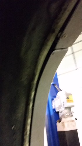

So while i was out on the trail last i did notice however that in the rear when stuffing the tires into the wells i was still rubbing on the very outside edge of my tire tread. Soooooooooo, that meant time to "roll" the fenders if you can call taking a hammer to them that lol.
So after this if i am still rubbing it is looking like i may have to try and pull the fender out a little bit to prevent the rubbing all together. Still haven't been able to take the front disconnects off yet. Found out they were too tight and that is probably why they wouldnt come off when i tried earlier. So loosened those up as well while it was in the air and hopefully once i get my rear rubbing issue fixed i can start looking more into the fronts and getting them to disconnect easier and make sure they are not rubbing as well... Any input with it all would be much appreciated!

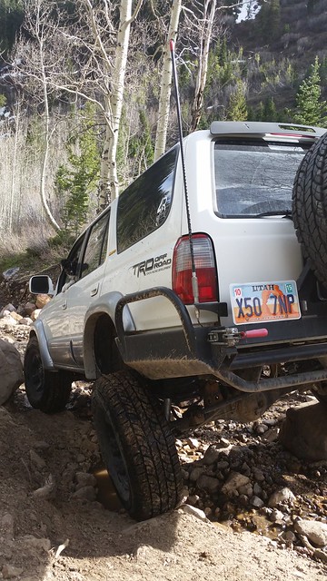

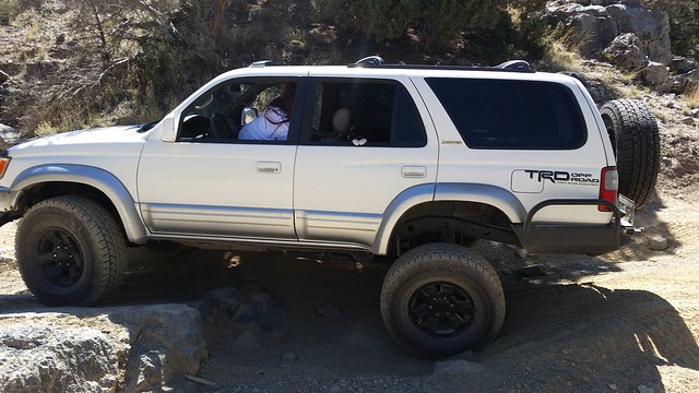

So i was able to go out wheeling over the weekend and test out the new "rolled" fenders in the rear to see if i am still going to rub and now i think that i am rubbing only on the rear bumper when i am flexed hard in the rear. But i definitely don't rub nearly as much as i used to. So that helped alot. Now to figure out this bumper and how to either hammer it out or cut it a little bit.

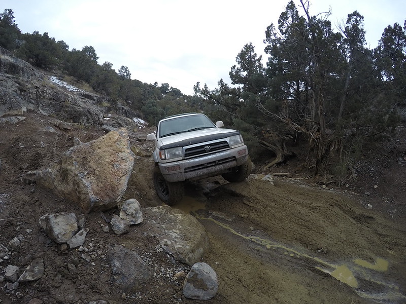

Decided to go out wheeling up the canyon for the first time this year and well it was fun but up towards the top started hearing a clunking noise in the front, got out and found that one of the pins on my front disconnect for the sway bar had fallen out or broke, so i just took that off and well looks like im just going to be taking off the front sway bar this weekend so i dont have to deal with that crap wheeling anymore.
A few other things probably going to happen this weekend is going to heat up the bumper close the the wheels so that i can hammer it in a little bit instead of having to cut any of the bumper to make the clearance alot better when flexing and not rub on the bumper anymore. Then hopefully will be able to go out and test the rubbing on saturday or sunday this weekend!

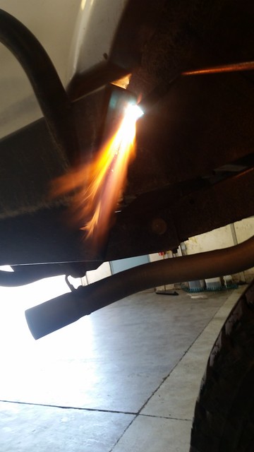

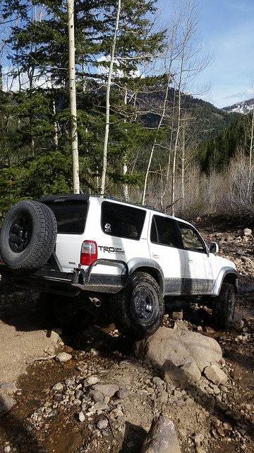

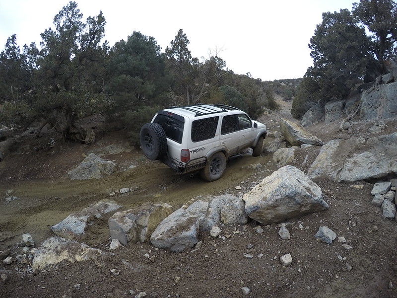

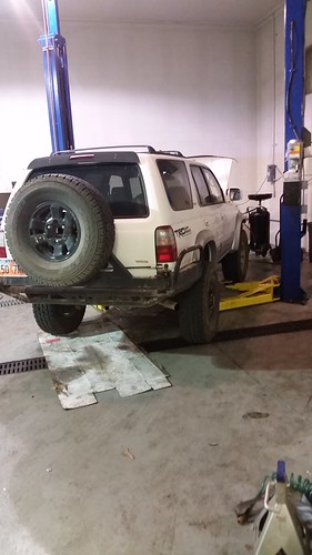

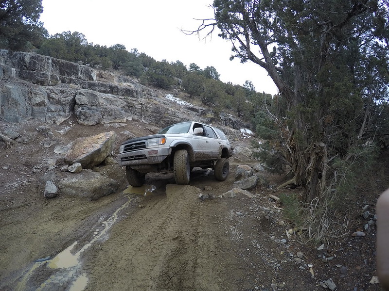

Welp, Friday went in to take the sway bar off and got that all done and off and the runner seems to feel alot better on trails now for sure. While i was under it found a torn CV boot so will be replacing that axle soon enough, then also was able to heat up the side plate by the rear tire on my rear bumper and hammered that in to prevent it from rubbing anymore when the tire is stuffed and seemed to work pretty well. So i was happy about that. Now onto getting the fronts to flex and not rub or anything.

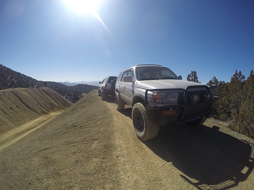

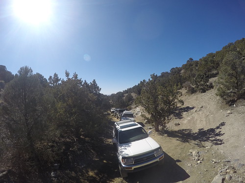

After all of that was done went out on some Trails on Sunday and Monday.

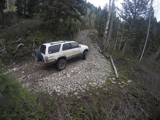

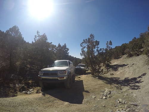

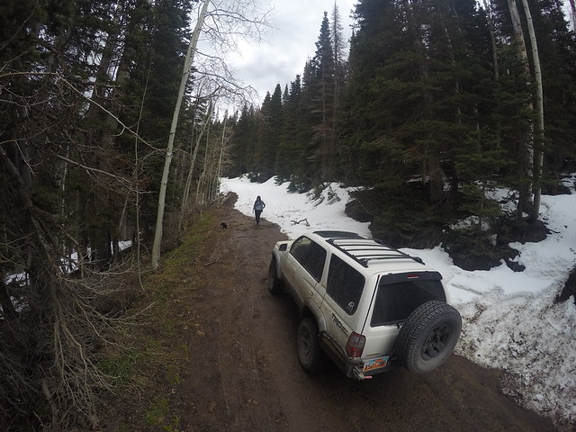

Out to 5 Mile with some others on Sunday morning:

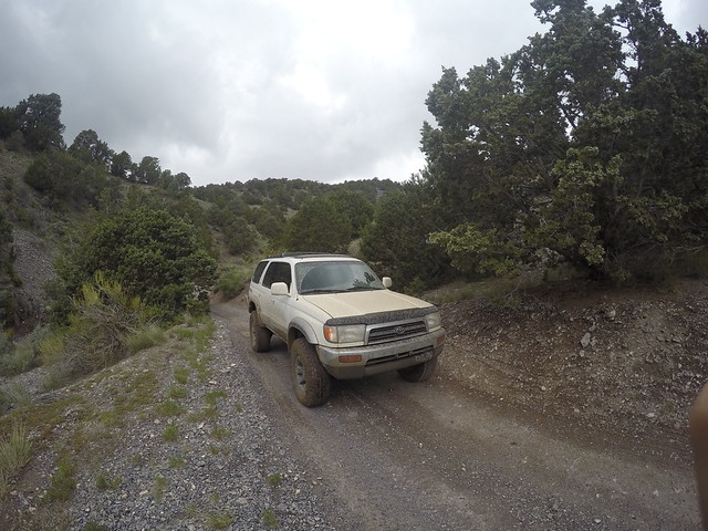

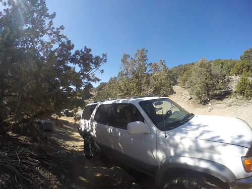

Then on Monday up American Fork Canyon:

Yeah but they were on the rear bumper and the top of the wheel well... so instead of rolling the fenders i hammered them, then heated up the rear bumper part and then hammered that back so it wouldnt rub anymore, and i havent really flexed it out enough to rub yet in the past couple of days. But yeah I did rub, but i also have 1.25" spacers which are part of the issue as well... Just depends on your setup, i am sure if i took the bumper and spacers off that i wouldnt rub.
