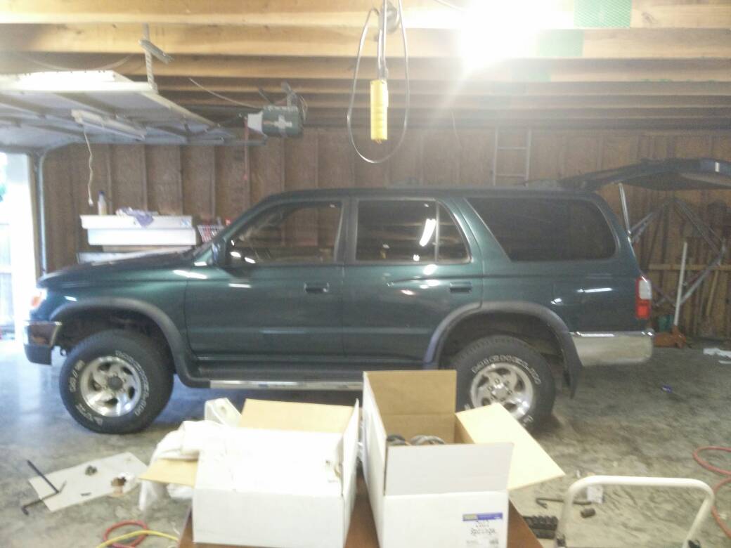

My 97 sr5 4x4 came with them actually. Thank you everybody for your posts. I had no idea that bigger tires could worsen the ride.. Go figure.
Sent from my A0001 using Tapatalk
Here is a picture of the stock 15 inch enkei wheels that came with my specific 4runner
Some 4runners came stock with 15" tires. Smaller calipers one would presume. Mine has 'em. More of a base model thing maybe?
Yes, smaller brakes go with the smaller diameter wheels/tires. It is a base model and non-optioned SR5 thing. My '99 2WD originally had the 15" wheels.
