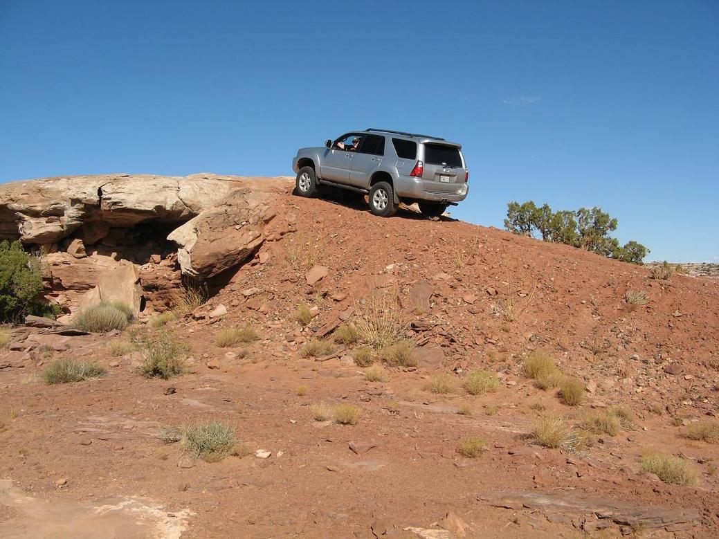

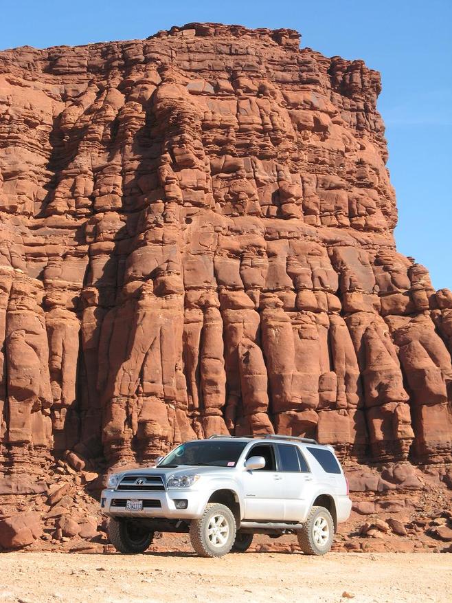

With my lift the rim was pulled in a little closer to the suspension and the edge of the rim was VERY close to the sway bar and the weights would hit on full lock turns. The tire installer installed the stick on weights on the inner surface of the rim. Now with the BFG KOs 275/65 17s I don't notice any rubbing.

Here's a few pics. I don't have any close ups yet
