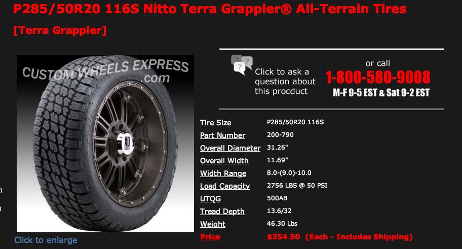

Just ordered some 20x9 inch +18offset rims for my 2006 black 4runner limited 4x2. Could I put 285/50r/20 nitto grapplers on these rims and not cause any problems without having to lift it?

It's only 31.26" which is shorter than 265/70R17 and only .66" taller than OEM tires.
The width will be a problem though, if you have too much offset they will rub the UCA. If you're not willing to at least put a leveling kit on and/or trim/remove front mud flups if they don't fit then I wouldn't get em. That is of course assuming the offset is alright otherwise lift won't help.

I went to the tire shop and had them hold a 285/50/20 tire up to the tires I have now which are 265/70/18. They are pretty damn close in diameter. The 285's are just a little bigger but much wider. I'm assumming I'm gonna get some rub in the front. So I'm just going to go ahead and put a 1 or a 1.5 inch lift in the front with a daystar leveling kit.

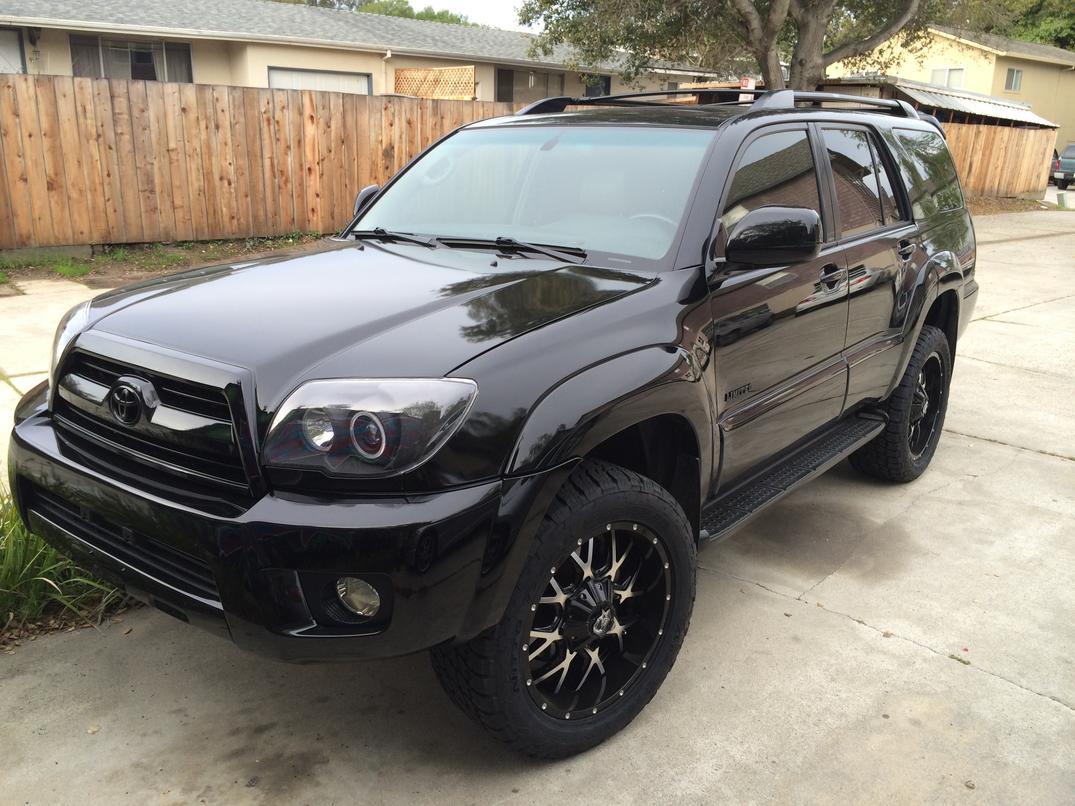

well, if anyone was wondering how it all worked out, the answer is no, those tires would not have fit. So i put on a daystar lift kit, 2.5 in the front,1.5 in the rear
The 285/50/20 do fit with an 18 inch offset with the lift just about perfect. I had to cut some of the wheel well shroud and just a touch of the corner of the inside corner of the bumper. did it with a box cutter, was easy and u can't even tell the bumper is cut just a little.
I also had to trim just a little of the mud guard on the inside, but again, it's not really noticeable unless you climb under the truck and look.
The rims and tires look bad ass! I'll post pics soon.....
