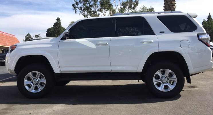

I'm a newb at this but have some questions. I have a Super White2016 T4R SR5 Premium 4x4 and just put on Bilsteins 5100's all around. Front set at highest setting (2.5) and a Rear DayStar 1.5 spacer.
Planning on getting the SCS SR8 rims (17-8.5) and (-10mm offset). Will 285 BFG KO2's fit without having to cut or mod anything else? Or should I get 275's so I don't have to worry about it??
Any advice please???

Short answer: you will probably rub on plastic, probably not rub on anything metal. You may have to shift the fender liner forward (see fender liner mod at above links) and/or cut or remould (with heat gun) some of the black fender plastic and/or mud flaps.
