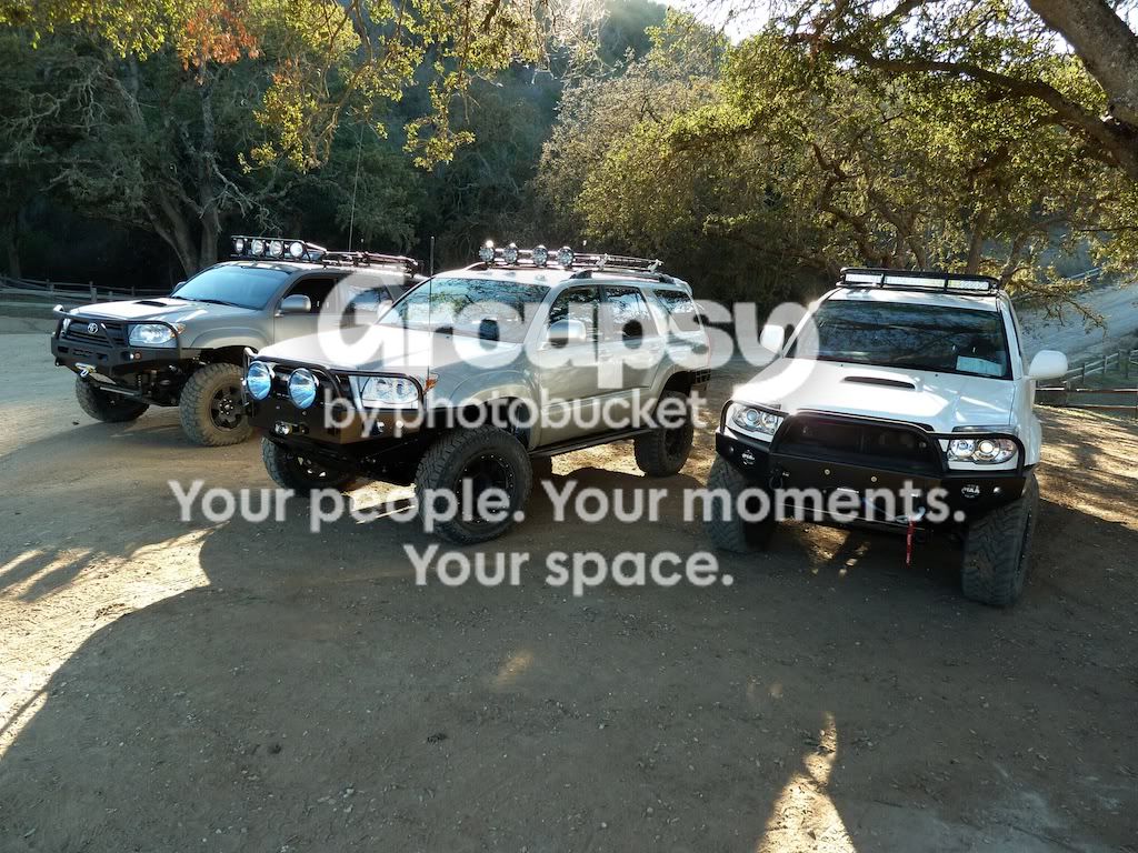

Not only will they decrease your approach angle but they can also cause additional damage to other body components in the event of a collision. You might want to consider replacing your front bumper with an aftermarket steel bumper if you want to increase your approach angle. In addition, you'll also get better collision protection, additional recovery points, and a platform to mount a winch and additional lights. Schrockworks, DeMello, PerkinsPerformance and ARB are some of the more popular brands.
2 Schrockworks and a DeMello
