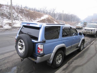

I'm not sure if you are aware of the swing out tire carriers that were on Hilux Surfs but not US 4Runners, but if you can get one of those it would be a simpler job to install then making a hatch bracket.
