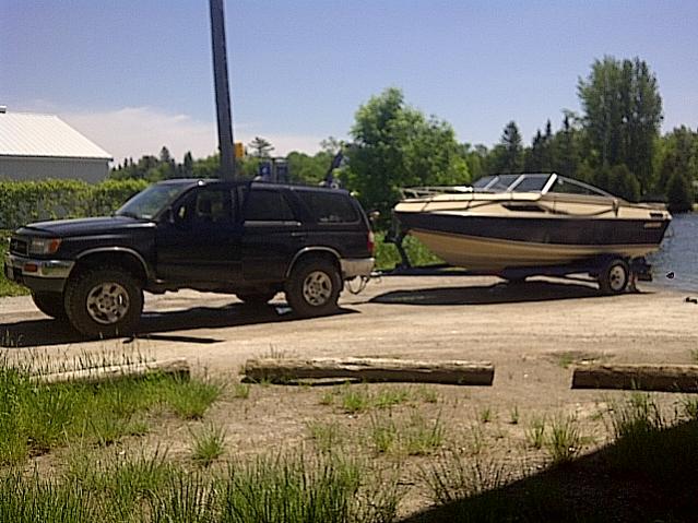

i pull this one in and outta the water all the time. haven't tried any high speed roads tho, usually just skirt around the back roads.
