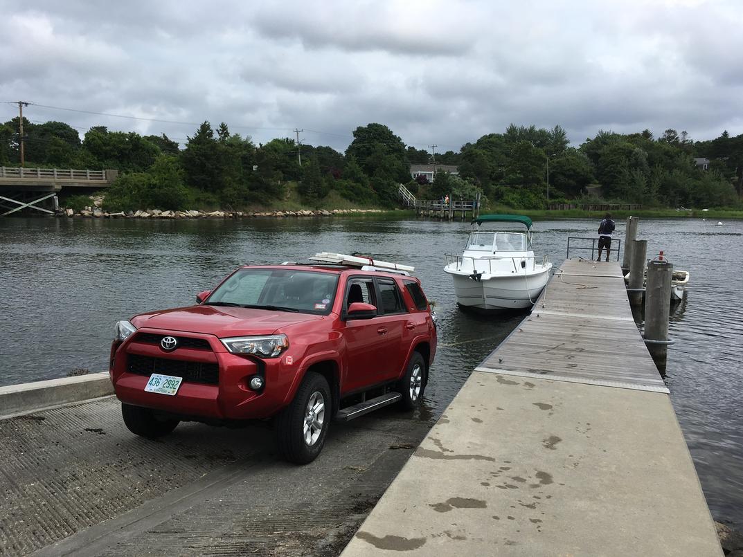

I tow a 22' walkaround with a 2015 SR5, factory towing package. Boat, motor and trailer are about 4300lbs. i tow it 100 miles a couple of times a year, up to 20 miles at other times. I never have an issue. I did install a transmission oil cooler befoer I started towing.
