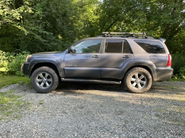

Last night the rear end of my 2008 4Runner Limited started sagging and bouncing over bumps when driving home. It has XREAS and RAS.
Does it hurt the vehicle driving it for a couple of days until my mechanic can diagnose?
Thanks
Here is what it looks like.

Personally I would be more worried about general saftey and getting into an accident more so than hurting the vehicle.
Just drop it off and ask the dealer for a complimentary rental... they almost always oblige.
