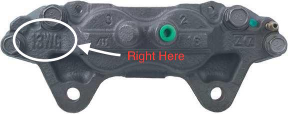

If your front calipers are stamped 13WG, you have the smaller brakes and 16” rims will fit.
I was “lucky”. My 04 Limited came with 17” rims, but has the smaller brakes that allow 16” rims. I have one set of 16” rims/tires.
Is that stamped on the inside or outside of the calipers?
