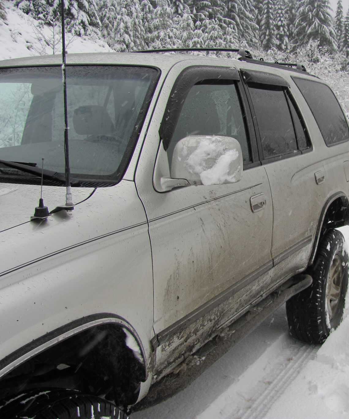

The little stubby guy beside my Firestik is my am/fm antenna. Works just as well as the original. I couldn't justify spending 60 something $ on an antenna since I rarely listen to the radio anyways.
