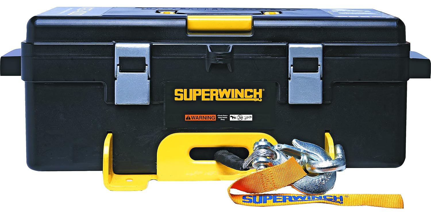

https://www.amazon.com/Superwinch-1...keywords=portable+winch&qid=1547740384&sr=8-2
$285.
Or
Winch https://www.amazon.com/Superwinch-1...36?keywords=winch&qid=1547740437&sr=8-36&th=1
~$400
Mount https://www.amazon.com/dp/B01KCHE43O/ref=psdc_15737591_t2_B008JCW9GY
$60
+ Wiring https://www.amazon.com/Rough-Countr...+kit&qid=1547740581&s=Home+Improvement&sr=1-9
$65
Front Hitch https://www.amazon.com/CURT-31367-F...ront+hitch&qid=1547740663&s=Automotive&sr=1-1
$170
Portable winch for ~ $700 that's a bit more capable. If the budget allows - get a winch with synthetic rope. It's a lot lighter weight to move around. Also I'd suggest getting the long wiring set so you can put the winch in either front or rear receiver hitch if you're going that route. A 4500lb ATV winch would probably work in most situations, but may not have enough grunt in extreme stuck situations.

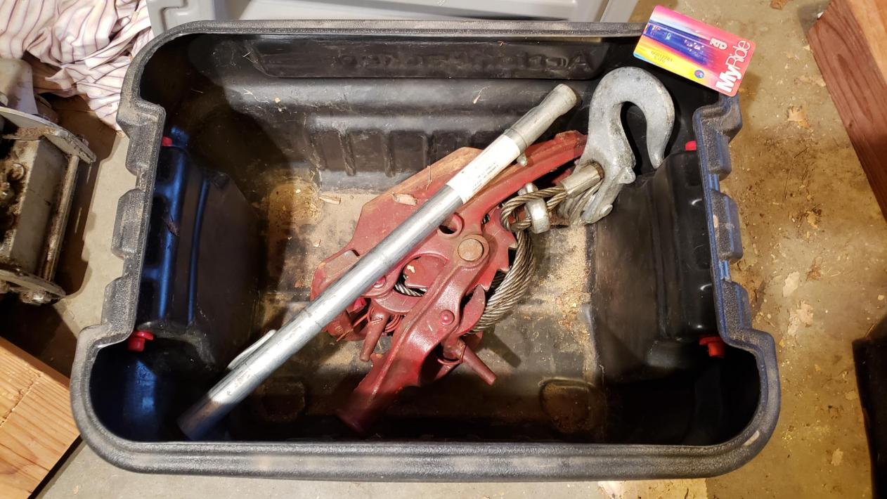

A Wyeth-Scott weighs about 25lbs. I keep mine in a Rubbermaid Mini (8 gal) ActionPacker that still has plenty of room for other recovery gear. I have a frame mounted winch so I don't always carry it so now I have a separate case for my recovery gear. It comes with it's own snatch block so you can double it up on itself, and you'd definitely want to carry a winch extension rope. Here's mine in it's tote - business card for scale. It's nearly 30 years old and I am debating sending it back to them for a synthetic line and the new hardware.

It's certainly lighter with the synthetic rope. Right now keep it in the truck in the original box in case I need it with the snow forecast. Need to pre-load the spool and find a proper case for it, but haven't had a chance yet.
