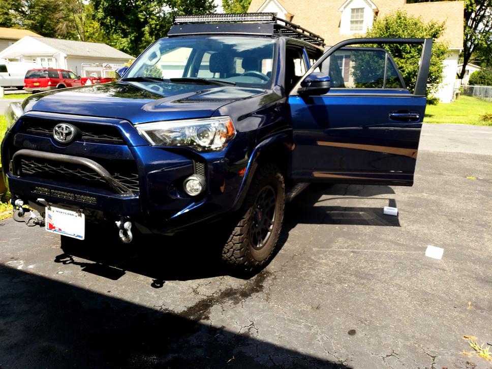

I personally went with the C4fab.
I have a Smittybilt X2O procomp12k winch with synthetic line, and a 20" light bar. I have slight sag on Bilstien suspension.
Yes she is a daily driver. But I want to be able to go on adventures and not have to worry as much.
***Disclaimer***
I upgraded my brakes prior to installing the bumper, so my braking distance is still shorter then stock with bumper and winch onboard.
These are 2 reasons why I went with C4fab.
1. The cross bar has gusset supports welded in (adds strength and rigidity).
For that oh $#!+ tie a line and pull moment.
2. The anchor points for the Shackles are a bit lower (almost inline with the winch opening. They don't stick out past the front edge of the bumper. (i.e. Shin wackers). The anchor point are also online with the frame mounts, not above.
Had C4fab made an aluminum option I would have jumped on that!

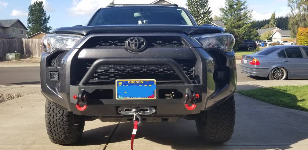

I went with a Warn hybrid/hidden since it was in stock and I could get it within a week.
Install was fairly easy and I like that it has extra bracketing to the frame.
Shipping Weight was 88 lbs.
I added a Tigershark 9500SR to it, so total weight was around 150lb.
The TS doesn't need a solenoid relocation with that bumper.
The front end dropped enough that I will do something about it. Maybe some spacers as a temporary measure but will ultimately swap out the springs and shocks when I have time.
