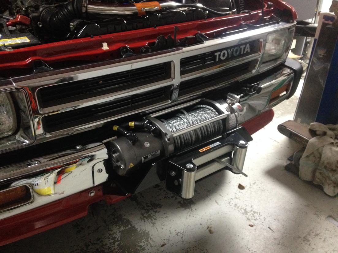

Finally found the time, and enough energy, to get my Warn M8000 winch installed into my Addicted Offroad bumper!
That was a tight fit in there, and I had to cut and re-weld the bracket that holds the solenoid box onto the winch. It was too close to fit without hacking up my grill, so I decided to just move the bracket's holes forward ¾".

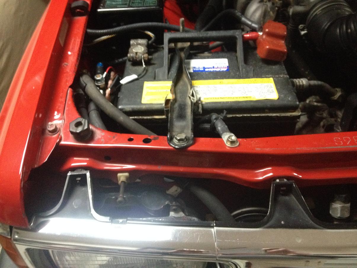

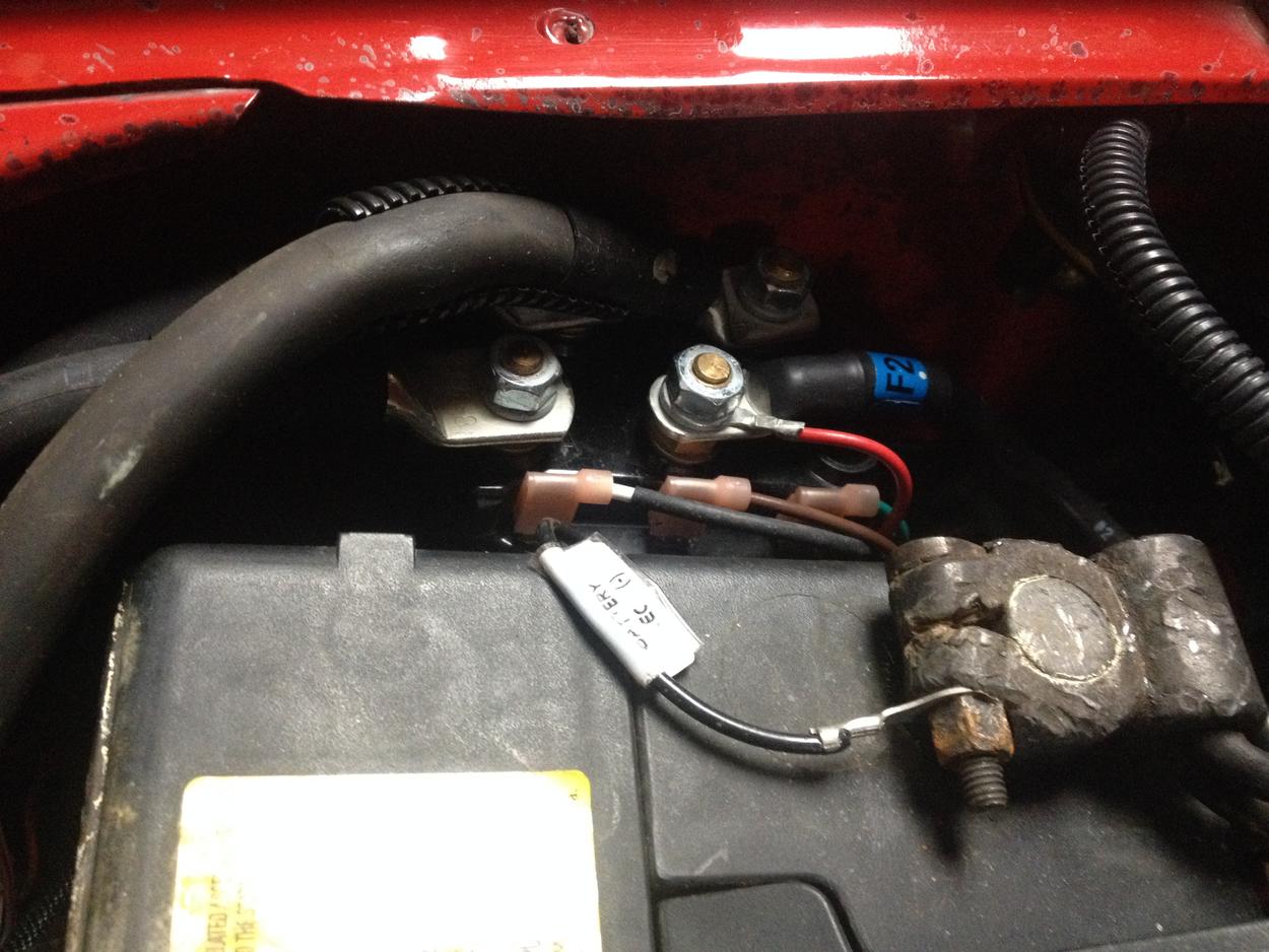

Wiring was fun too, I ended up having to clean up all my old wiring crap at the battery to get it all to work well, but at least I have all new wiring for the ground and hot sides, including new terminals I bought for the Supra but never installed.
