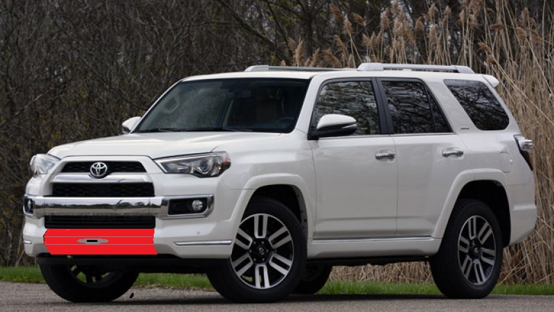

The limited has an easier bumper to make look pretty with a partial winch bumper. On a limited I would not cut the front bumper. I think I could fab one easy enough that would use a steel cover plate overtop of the existing bumper with a few holes through it for mounting hardware that would effectively sandwich the lower cross bar.
30 second rendering...
