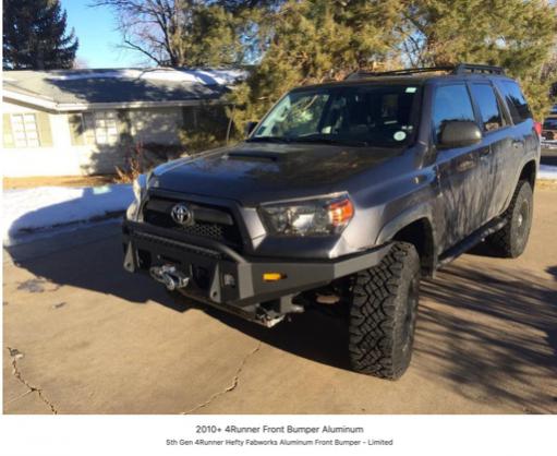

Photos of bumpers for Limited
So, I'm trying "manage attachments" and it looks like a photo was successfully uploaded. Here goes
Trying that photo again--bigger size with info at bottom
Better photo, I hope

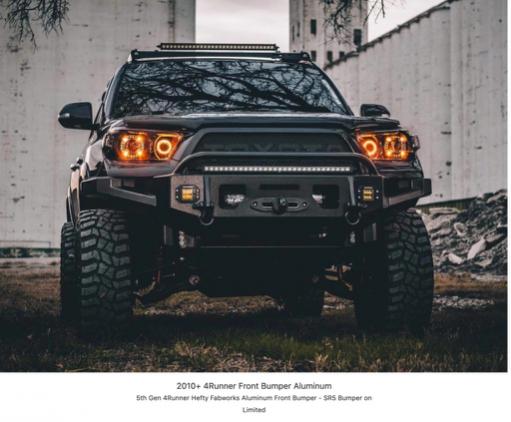

Second photo of Limited bumper from Hefty
This one uses an SR5 to start
