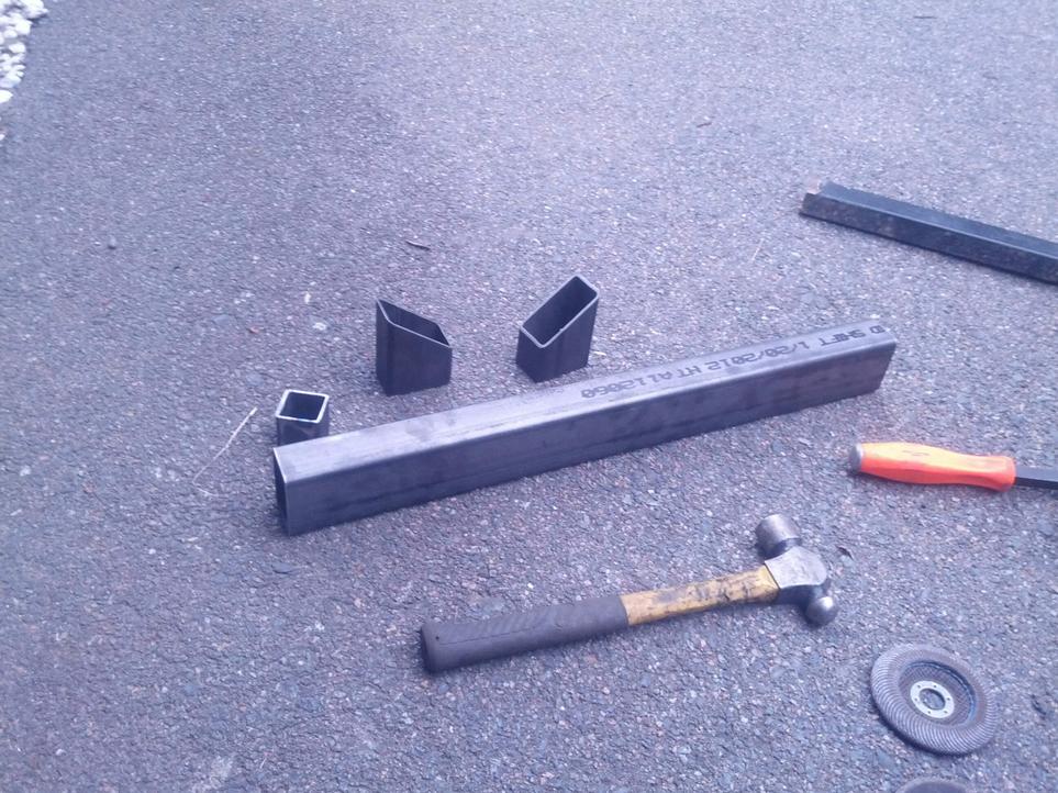

Its been a little while, but I finally had a chance to cut some pieces out for the winch mount at work. Extending the front frame rails 4in at the top and 2in at the bottom with a new crossmember to fit the winch mounting plate. 2x3 11g tubing, same as the existing frame rail. I'll be getting everything mocked up and hopefully tacked in place tomorrow.

Already in the process of making my own, but that one looks pretty slick!
My front crossmember will be held on with more than 2 bolts though :thumb:
No fooling! The bolts really should be just to hold it in place until you can weld it up. I was going to make my own but the C channel I was looking at cost almost as much as this part WITHOUT the nuts welded on for the winch mount. Fortunately these guys are the next town north of me so I think I'll swing by and see if I can get a cusomized version...

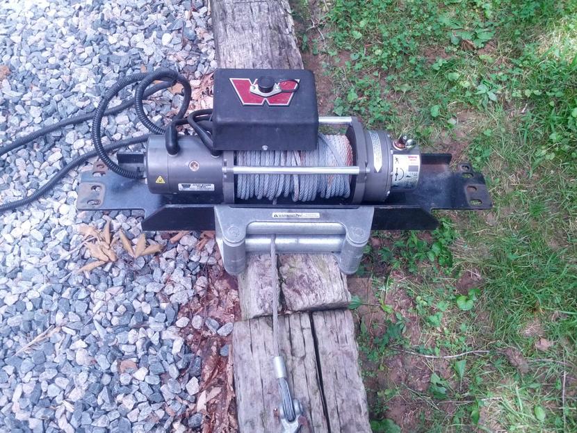

Oh yeah and I picked this little guy up over the weekend. That's where the new found motivation came from. $100 bucks for a warn M8000? uhh yess!
came with no remote, any one know where to get one for older warns'?

Nice score.
Hard a 2way toggle switch into the housing. Just cost you a switch and then get a replacement remote when the opportunity arises.

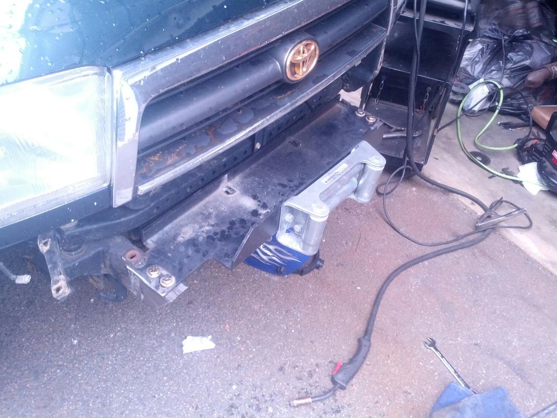

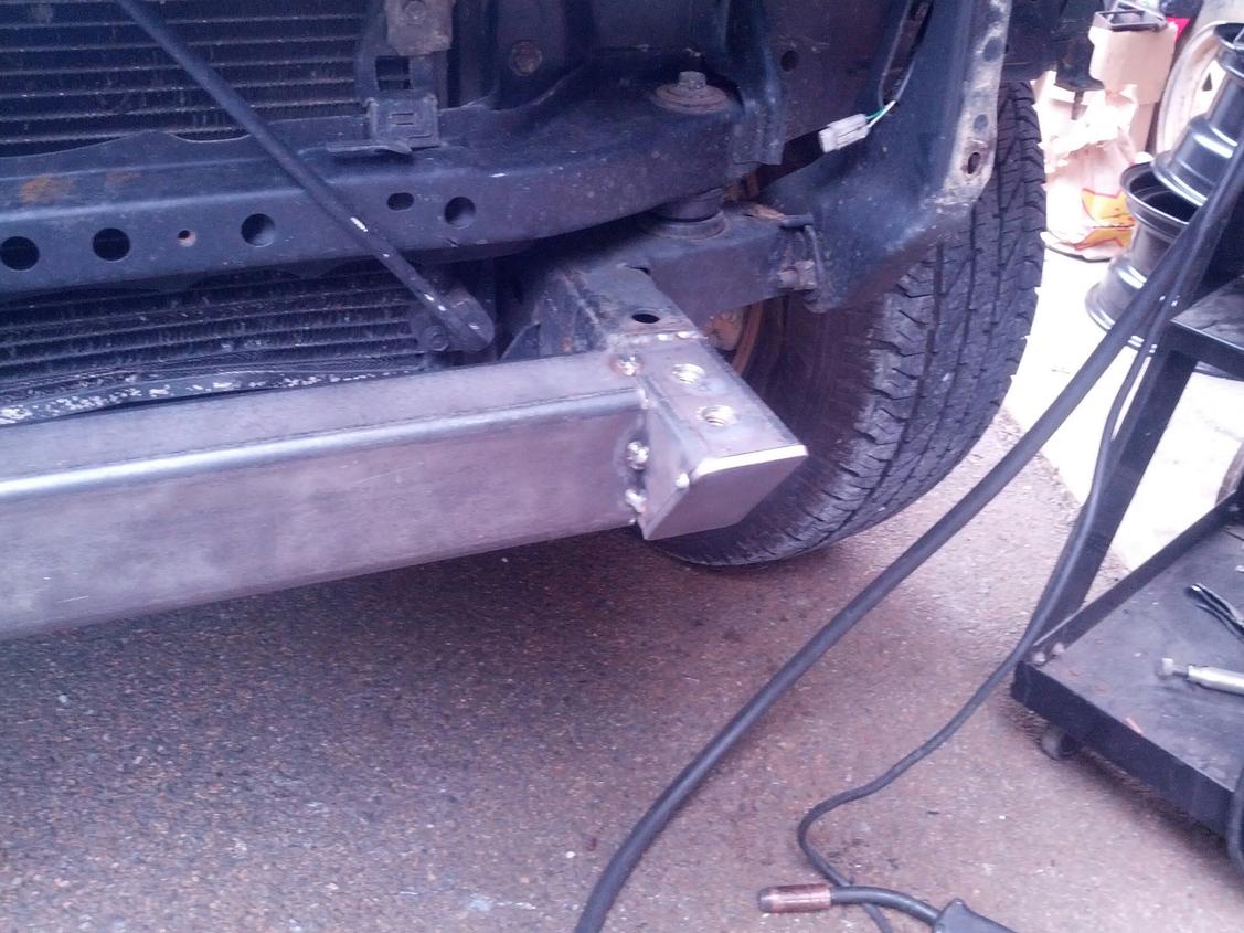

Well got everything tacked in place for the most part, but I ran out of shielding gas. The extensions are sleeved on the inside, welded then welded and ground on the outside. I welded nuts on the inside for bolting on the winch plate and then boxed in the ends.
Total I have $100 in winch and plate, $15 in tubing and $9 in grade 8 bolts.
Hopefully I can get a new tank tomorrow and finish up.

Been planning on doing this for a while, pretty much the exact way you are doing it. Please hurry up so I can copy it! haha I want it hidden as much as possible, but it is not an easy thing to hide without a fatlip bumper.
Well it should have been done today, but I couldent get anymore shielding gas :redbrick: mine won't be too hidden, Its pretty much impossible with out a fatlip bumper like you said. After I put on my 1'' body lift I will still have to cut out a 1.5''x 20'' section of my chrome bumper. That's with the winch plate in as far as it will possibly go. My main goal was just to get it in as close as possible so that it won't kill my approach angle and I won't be hitting it on things. Looks come 2nd

$100 for a M8000? I hate you. Very nice score. Make in-cab controls. I did. It's so much nicer than dealing with the remote every time.
yep :) Ill look in to doing the in cab controls it sounds like a good idea. I might send you a PM with a few questions when the time comes.

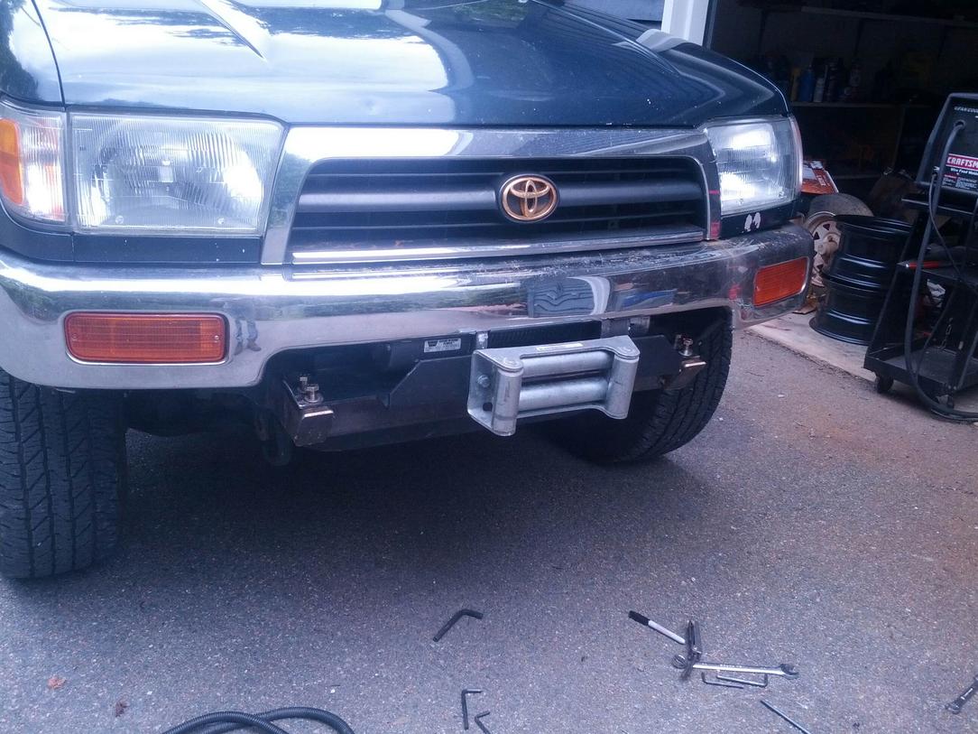

everything is not welded up but I had to see what it is going to look like.
with no body lift I had to do VERY minimal trimming to the bumper. with the 1in body lift it should clear no problem.
only down side is its hard as hell to get to the free spool lever.... witch doesn't work anyways for some reason?
sorry for the crappy cell phone pics.

That looks really good, most of the ones I have seen with the regular bumper mounted them under the frame rails. I am sure it would be fine, but it looked a little low in my opinion, not bad at all, just a little low. The freespool lever was something that worried me as well, I might try clocking it so it sticks out the front instead of on top where it will be almost inaccessible. I already have a 1.5" body lift so after seeing this and reading what you've said, I am excited to get it on there. Hopefully I can get my welding tank filled and some 2x3 tubing this week.

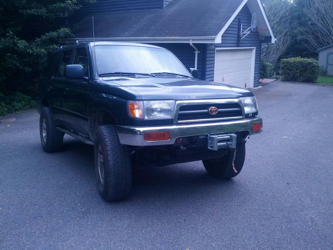

I got everything wired up, and painted. That is how it sits for now without the body lift.

Looks good. I might copy your mounting idea. Does the fair lead decrease your approach angle at all? Do you think if you clock the winch the free spool leaver would be more accessible?
