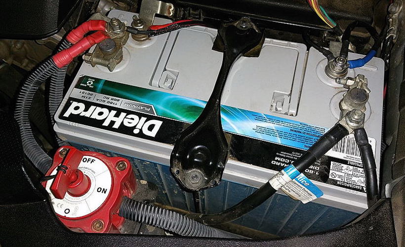

I made a small bracket and put a Blue Sea 6005 switch on mine and it was less then $25 on Amazon.Cheap insurance!
3 good reasons
Easy to reach Safety switch in case winch relay sticks in on position and can't be controlled by by my wireless/hand controller which can happen. I've already had one winch scare in my life and respect that dude now!!
Powered contacts like the winch relays will corrode faster(galvanic) if powered all the time especially where it's sitting down low and frequently gets soaked .
Safety from shorts in case of front end collision as the winch is right on the front bumper.
