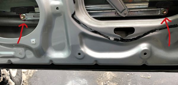

You should now see this, and the 2 bolts that need to be tightened should be visible.
attachment.php
