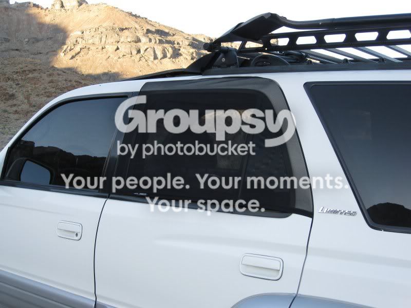

CYi5 bought them a while back but bought the ones for the 01+ CR-V and he reported they worked great. I do however see they make them for the 3rd gens. I don't know how recent they were added or if anyone has tried them. You can be the FIRST! Toyota Forerunner/Hilux/Surf 2001-On Window SOX - Window Sox USA & Canada
Here's the 01+ CR-V ones on his 4runner

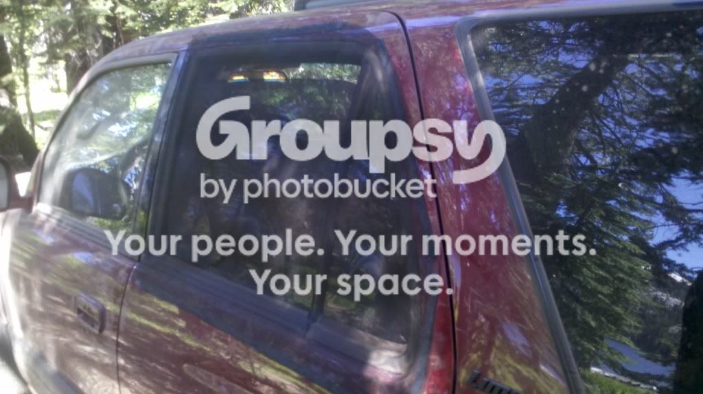

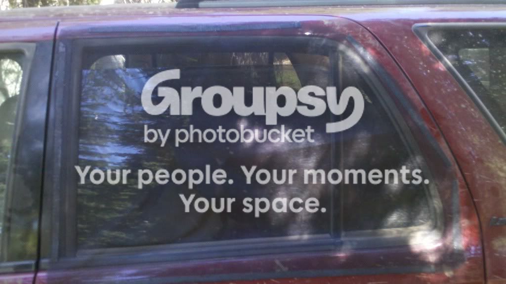

I made some using magnets and screen door mesh. Cost me about $15 and well worth it. I just traced the outline of the door around the rear windows and cut. Then used super glue (glue gun works better, but I don't have one) and glued magnetic strips to it. It worked perfect and can pack up small. Next time I'm going to add some felt like Izz to protect the paint. It was definitely worth it since I could have my windows down for ventilation during the night and day and not get any bugs in.

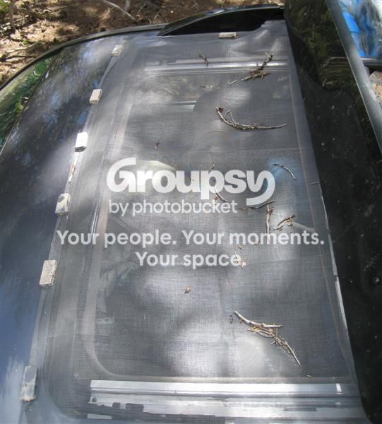

This simple setup works well for me.
Home Depot has the screen and the magnets pictured. The magnets are powerful but fragile and they chip and fall apart fairly easily leaving magnetic dust stuck to the magnet. I wrap them up in clear tape which makes them robust and only slightly affects the magnetism which is still plenty strong.

They're tougher but I've had plenty like that come apart, too. I keep some in the truck at all times along with some very thin mosquito netting so that I'm never caught unprepared. The setup in the picture is my "I'm now going camping" setup.
