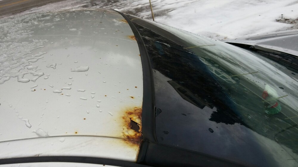

I'm mentioning this just because... But when you have it replaced, try to make sure (and see if you can get it in writing) that the shop replacing the glass touches up any scratches they make while removing the windshield and ensure they seal it properly. I've seen too many cheap replacements here that are rusting on the roof due to this. See the attached pic of my fiances car. Just food for thought :)
