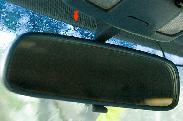

My windshield leaks when it rains. I probably need to bring it to an auto-glass place & have it resealed but I figured I'd run this by you folks first. Anyone have an el-cheepo, down-n-dirty fix for a leaking windshield?
It drips from just above my rear-view mirror.

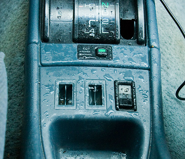

This can't be good for my center console.

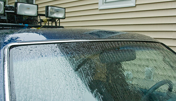

The trim on the outside seems to be intact.
Any ideas?
where do you live ? I wonder if it's rusted out under the trim<!-- google_ad_section_end -->
It's quite possible. I had similar leaks on my Maxima and Trooper, both had rust under the gasket. :(
wow .. thats quite a bit !!
pull the windshield FOR SURE .. and have a look .. about all you can do for now !
and the longer you leave it , the more possable damage could occure , including rusting floor boards ..
That sucks. Definitely pull the chrome lining off and see if it is exposed. That's nothing compared to the leaks I had in my 87 t4r in high school. If I turned too sharp I would get a shower and I always kept a few towels in my t4r to sit on and hold the water back. It pretty funny.
