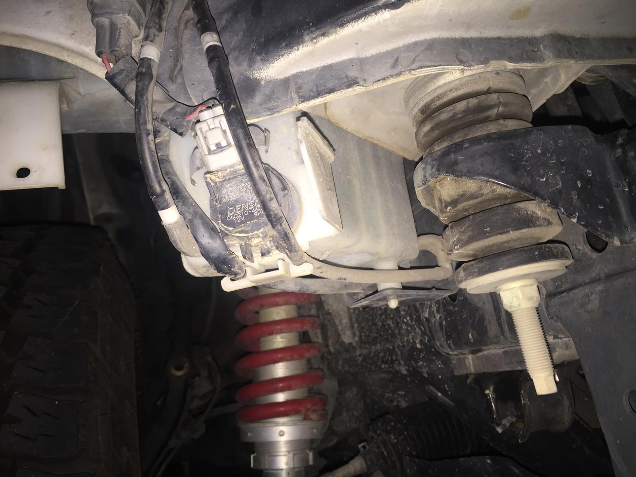

It has two pump one in the front and the other on the back side of the tank. I would try some swapnostics or check the voltage going to the pump not working if you have some one to activate the circuit. If both pumps are good i would discount the line coming off the pump the the spray nozzles and blow compressed air through the line slowly and blow out any debris that could of gotten in the line or are clogging the nozzles. I have found out in my years of working on construction equipment that when the tank get ran dry that simply just refilling the tank wont do it you need to purg the lines before youll get fluid out.

Thank you both for your help. I got this fixed today. I checked at two Toyota dealerships and was quoted prices of $85 and $62 for a replacement pump. After blowing that off and spending $23 at Napa, I spent 45 minutes in my garage doing the replacement. Turns out, the housing at the top (outside) of the original pump that carries the electrical connections was broken and had slipped off its mount.
The hardest part was putting the new pump in. I couldn't get it in with the grommet attached, so took the grommet off the new pump, put the grommet in the hole in the fluid reservoir and then popped the new pump in afterward. Worked perfectly!
For future reference, the pump for the front is the easier one to get to - it's the one closest to the front bumper. The rear one is a bit higher and closer to the driver side of the car. I'm glad that one is fine because it looks like getting access to it would have been a LOT more involved.
