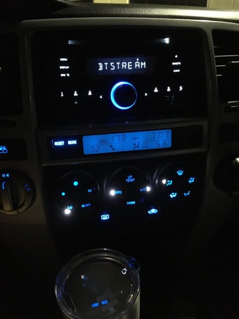

2. On the dash, just below the radio, I have that part that tells me the outside temp. A few of those bulbs are out. Does anyone know where I can get replacements without going to the dealership?

I had those bulbs out and couldn't find them anywhere other than the dealer. You can get an aftermarket bulb and solder it into the existing socket but then the color wont match. I ended up getting them from the dealer, I think they were about $8 a piece.

Thanks! Mine was never lit and was thinking..maybe only the radio lights up. Now I have to figure out how to take it apart to replace the bulbs! LOL
For LED bulbs you can go here...
https://www.superbrightleds.com/moreinfo/subminiature-bulbs/neox-led-bulb-instrument-panel-led/220/
Note that the high power ones (also found on this site with HP in the title) are for 12V operation. The ones linked above are good at the 4-6V output at that portion of the instrument panel. If you choose to use LEDs they may not work the first time because they need to be oriented correctly (polarity sensitive). If they don't work at first, flip them 180deg in their socket.
