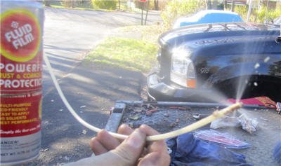

For those of us with older trucks, is there a good way to get inside the frame rails? I've been slowly going over mine and removing/spraying surface rust, but I'm afraid it's rusting from the inside out.

You can buy this hose from fluid film to get the inside of your frame. This hose attaches to the can and the nozzle has a great spray pattern. Every 1ft-1.5ft there are holes in the frame that are convenient for feeding in the hose. I used this method earlier this year.

I did some major frame prep and chassis saver paint when I bought my 4runner a few years ago, then been touching it up with rust oleum rattle can where it's scraped off and fluid film in the fall all over frame and suspension parts. In the spring all the crap just pressure washes off easily. I also use the spray hose inside the frame, really easy to apply. FF is still seeping out of some of the frame openings from an early spring application, not sure what it looks like on the inside but makes me feel better.
