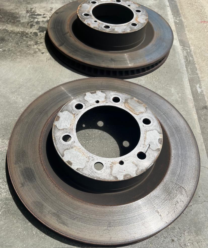

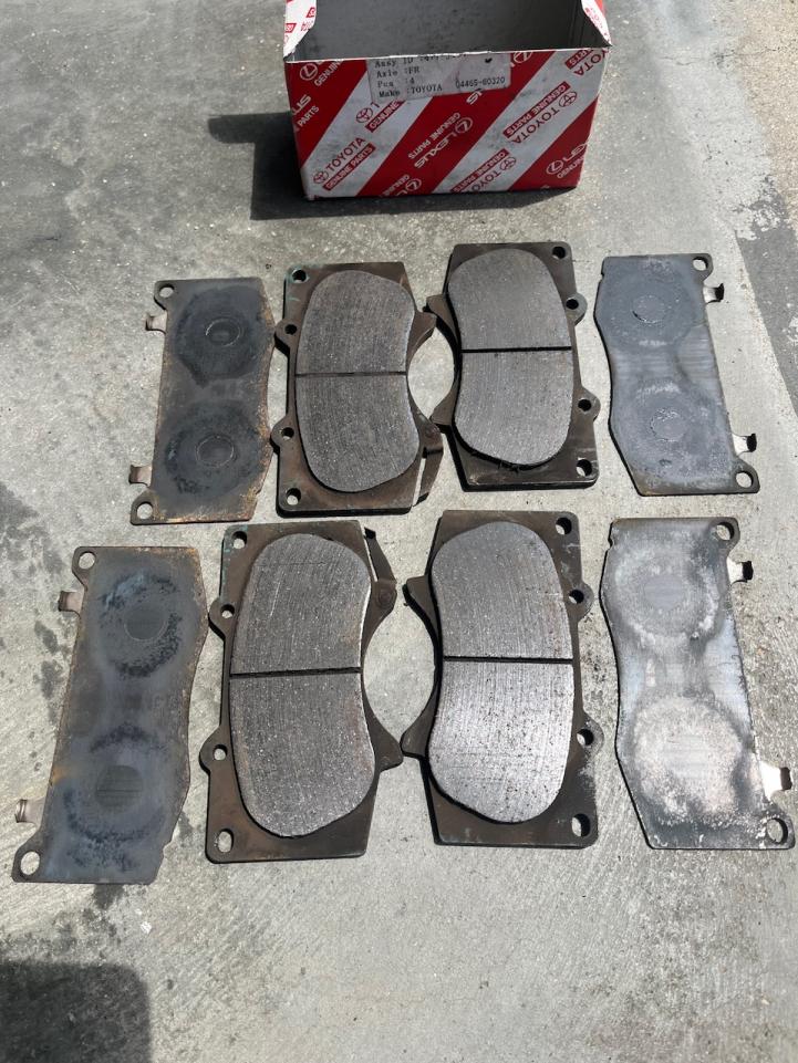

I started to get pulsation on my original pads and rotors at around 100k. I could clean them up by “rebedding” them on the long mountain descents I often take.
The rotors still spec’d fine in thickness and runout was exceptional but I still decided then that I would replace my rotors when the pads were under 5mm. Also, after 15 years the rotors started to look like crap as far as rust and I had no interest in turning them when I got the new ones for $60/ea.
In the last 10,000 miles the pulsation was becoming more common and i decided to do the brake job “early”. Changing the fronts only but everything went smoothly. Bedding felt great. I will test more on my next trip over the sierras.
Out with the old…
Ps, the grooves look far worse in the pic.
