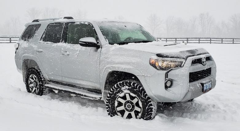

I am in Canada, and sold my second set and 2nd rims and now run BFG KO2 year round.
