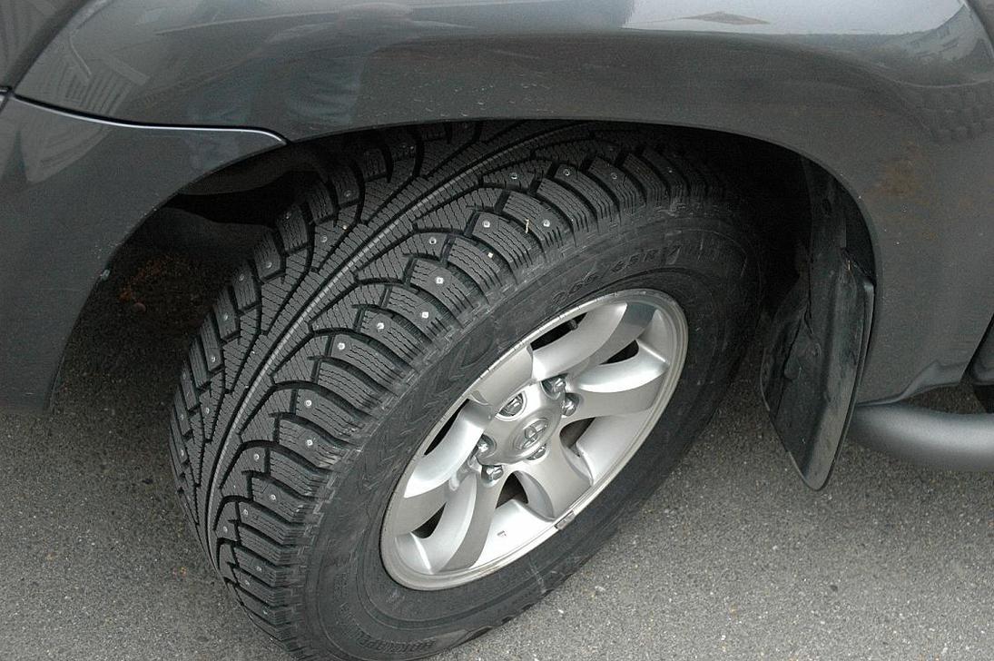

Nokian hakkapeliitta the answer to ice/snow.
:iagree: Studs are the way to go if you drive on roads with snow/ice at least 10 days a month. I recommend Mastercraft Courser MSR studded! Unbelievable traction in deep snow and amazing grip when the road gets slick! :driving:
