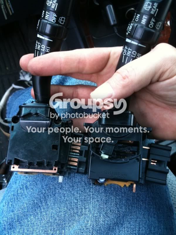

Unfortunately for me, the wiper switch I bought off ebay did not fit my 4runner.
Hopefully the seller will refund me but, hell, I only spent $15 shipped for it.
eBay replacement on the left, Original on the right.

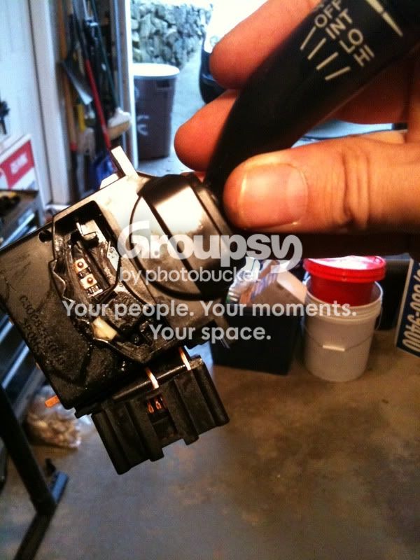

Thankfully after inspecting my original switch, it became apparent that all it needed was a good dose of contact cleaner. The four main contacts for the off/int/lo/hi positions on the stalk are exposed and were easily cleaned with a few shots of contact cleaner.
IMG_0638.jpg~original
After reinstalling the original switch, my wipers park perfectly as they should. Should come in handy as we are expecting a bit of rain for the next few days here.
