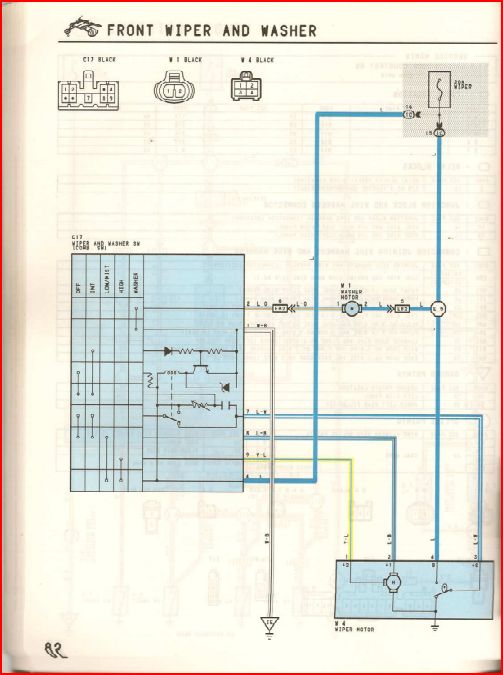

Wiper park switch
Inside the motor is a switch that is cam actuated and provides power to the wiper motor when it is turned off until the park position is reached. I don't have a motor to look into but I have enclosed a PDF image of the circuit. Maybe the switch is broken or a wire is loose. The one from the junkyard may have the same problem as yours. The illustration shows the cam switch at the bottom right of the page
