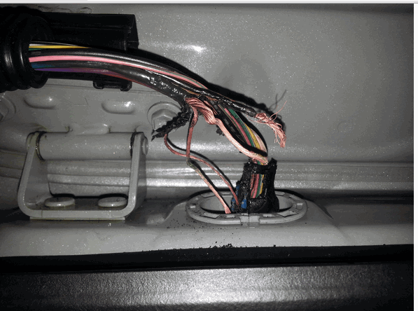

Wire harness fried going into tailgate..wires are hard, broken and some are stripped of insulation. Not a good fit for a solder/wire redo.....unless harness is out of Vehicle...if at all...Fuse Power 30 A is done as well ...tried to take it out but pink casing crumbled...so that will be another challenge to free contacts for new fuse...
Never replaced a harness and really do not not know how to proceed..any ideas. thx in advance. trdr.

https://mail-attachment.googleuserc...179&sads=w43jFufbAzyvSmyLD7Qa3-fDZ5o&sadssc=1
As U can see...I don't think I have enough wire to crimp/solder in new connections...not sure how far into the door the wires are exposed/fried....it must have been a slow process at the beginning bcs it discharged the battery without blowing the 30 Amp fuse responsible for (Powerwindows/power back window/powerlocks etc.). Off course now the fuse is history....
