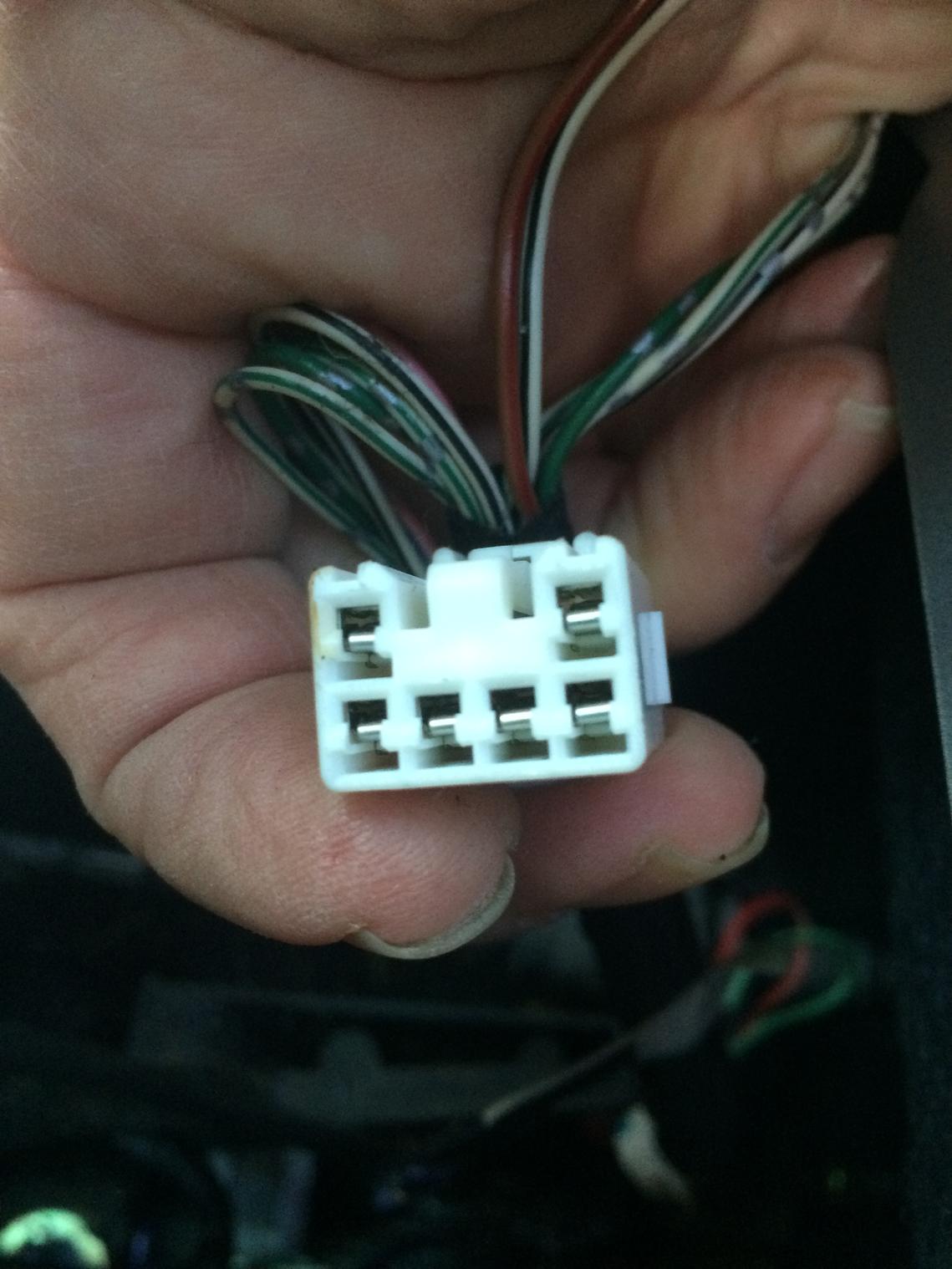

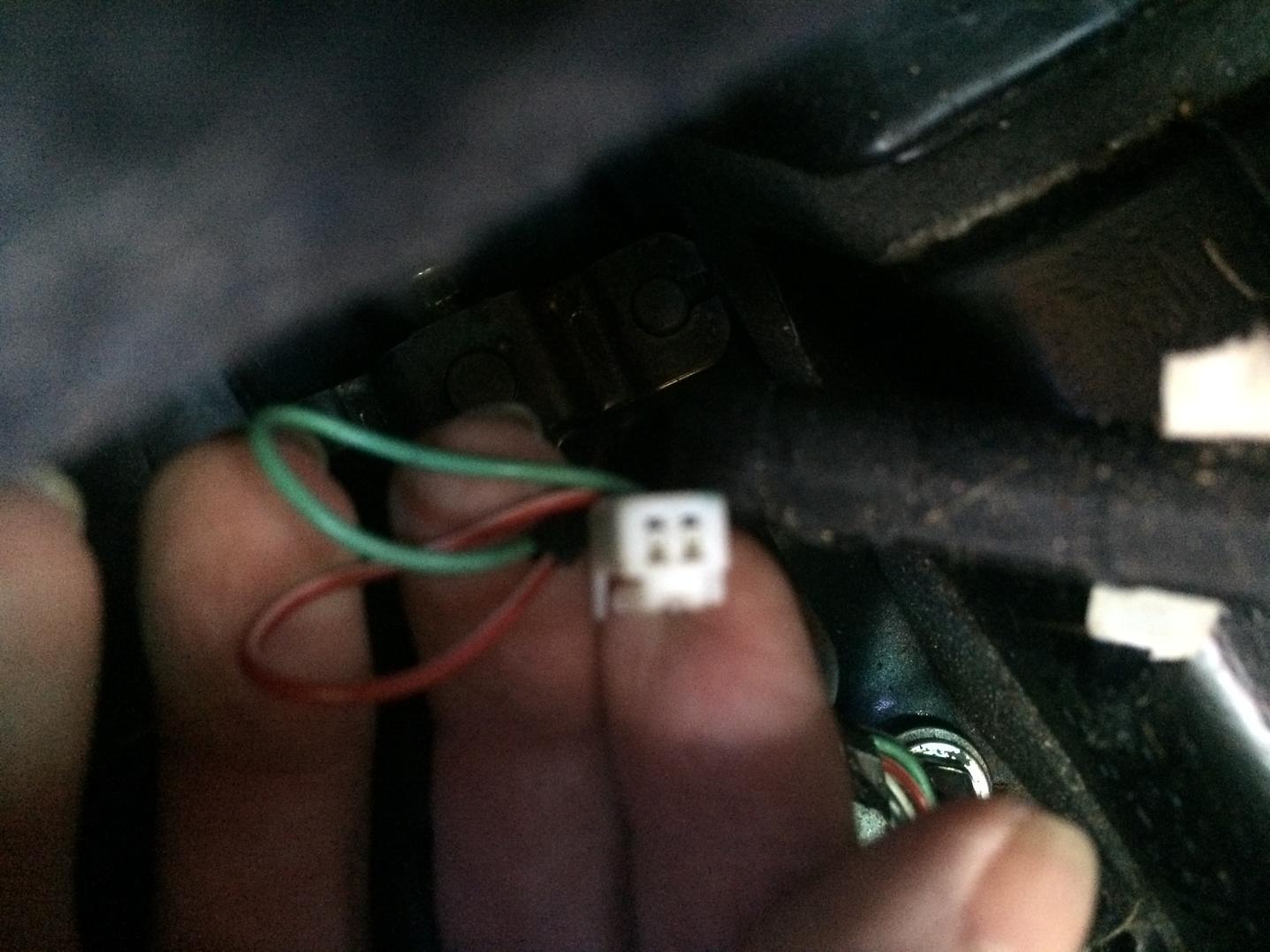

I was replacing the t5 bulb in the console shifter indicator and noticed these 2 harness? Does anyone know what they are? I'm an 05 SR5 V8. Thanks.

Small one if for the inverter plug. Big one I think might be on board air, but not sure. I don’t think that’s for seat heaters though.
Looking at the 2007 Wire diagram the AC inverter has a two wire connector, one wire is red with white stripe and the other light green, so that top one looks like that circuit.

The shape and color of the connector in the bottom pic, the 6 wire one, is the same as connector S24 and S25 in the 2007 EWD. If that is the same connector, then you should have 2 of them and they are for the LH and RH seat heaters and would power the harness to the seat. The wire colors are different than my EWD, but that could be just a year to year difference as your is a 05 and the EWD is for the 07. I thought it might be the air suspension but the connector shapes don't match up at all.
Maybe someone with the 05 EWD can see if the colors changed.

Uhhh... I’ll pull apart my console and look, but that is definitely not the seat heaters. My limited’s seat heater connectors are in line connectors, not double stack.
Edit- actually, I’m almost positive that big connector is for the smokers kit.
That larger 6 pin plug has power to 5 pins, and gnd to one. They are on the 10 amp Cig fuse.
