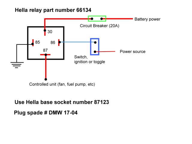

Accessory(+)/ground(-) wire goes to your switch. A trigger (+) goes to your relay. I never tried to wire in the dimmer. If that doesn't help then check your relay.
Here's an example for your relay.
